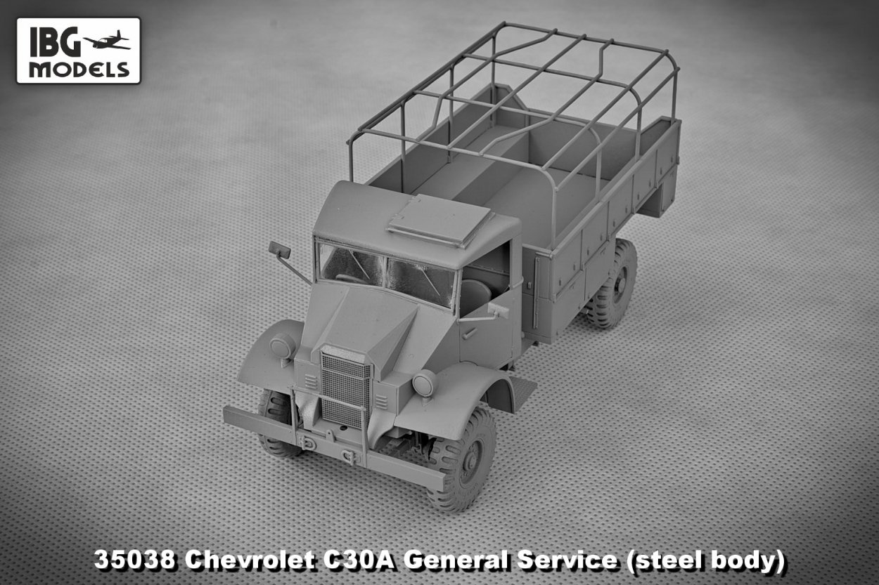

Has anyone completed the newest CMP in 1/35 of what is listed as IBG 35038 1/35 Chevrolet C30A General service?
Presumably the errors in the size of the Number 12 Cab will be the same as with the tanker, and presumably there isn't a 13 Cab included with this steel body, otherwise it would be mentioned. I was hoping to use it as the base for a C60S derreck with A frame at the rear.
http://en.ibg.com.pl/en,ibg-35038-1-...l#.WF2wOfNXU5s
Hi Larry. Not got the IBG C30a, but looking at the sprues on their website http://www.ibgmodels.com/35038.htm it appears that they have done it again with the Ford intake grills!!!! No 13 cab with this one, unlike their C60 kit.
To get a Chevrolet body for any of the IBG No.12 or 13 cab CMP's, you are going to have to cross-kit with one of the Mirror Models C-60 kits! You can't even build it as a Ford, as only the Chev 6 cylinder engine is in the kit (no Ford V8), and the axles are Chev 'Banjo' types, and they only appeared on very early Ford No.11 cabs!!!! Another confused kit from IBG....

With such wild combination of Ford and Chev features IBG will increase the sells of Mirror Models for sure!
It looks Ford on Chev chassis... With Chev radiator guard, though.
I have the feeling those people weren't even bothered to use Google to search more info on the CMPs. And there is a plenty of it in the Internet. Here for example.

Perhaps Kimmo can give a run down of the corrections needed for the IBG kit in 1/35 scale of the C30a?
Assuming the engine is a Chevy and the axles then the front vents could be scraped off and a round hole could be drilled through and plated from behind to represent the Chev style. What else needs doing?
Larry Hayward
