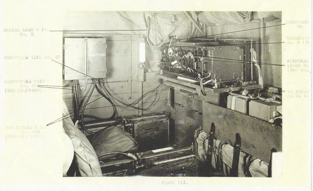

This is a C8 or F8 in the foreground. You can tell by the space between the locker and the cab.
That's definitely an 11 set and the charging switchboard is the right size to be the No 1. Nice find on that pic!
The power supplies are both in place to the right of the set. You can see the top edge of the plotting board behind the operator.
I wonder why there's no chore horse or spare tire.
The second truck looks like a Dodge.
yes ..... I agree . The antenna base looks like the 'battle' British base with the rubber rain shield and the 7/8" rods
What is the rectangular box to the right of the 11 set ? Its the charging switchboard ?

The charging switchboard is to the left of the radio. It's mounted on the front of the body. This is the only picture I've seen where you can see the switchboard.

If that is a charging switchboard No. 1 , it is the first and only pic I've seen with it installed in a C8/F8 .
The factory pics of the C8/F8 only show the operators light , nothing else .
Is there a Canadian built Charging switchboard No. 1 ?
It looks to me, those Kiwi's have pinched a British wireless set and accessories , maybe salvaged from a wrecked British 8cwt .

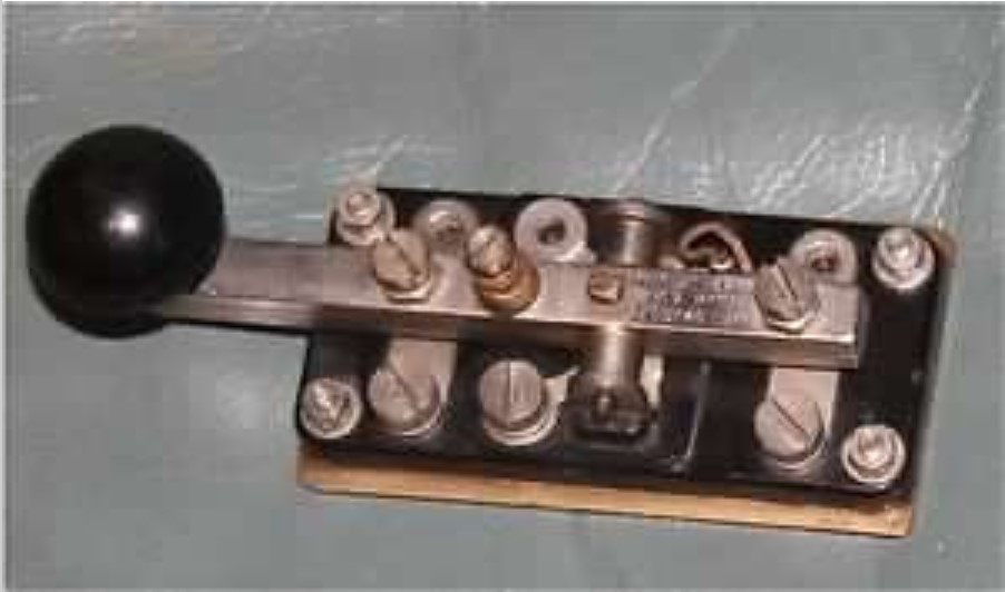

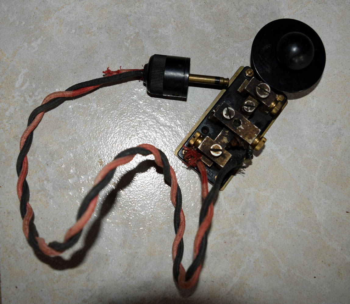

I got this key off ebay for parts. It's a ZA3145. What wireless set is it for? I saw one on the net and the brass mounting plate said ZA4500 which is for an 11 set. I'm assuming the plate had been swapped. I used the plate and finger rest on my other key.
The third picture is the strap on assembly that I thought was a No4 assembly but it has a US J37 key in it. I thought the cover looked a bit too wide and a bit too shallow. The seller said it was for a 19 set.
I included the flashlight in one picture just because it's kinda cool!
I was looking for a different wire than the red and black one I have for my Morse key then I looked at the blue yonder page. He says red and black is original! Who'da thunk it??? Now I just need the slide ZA4381.
Not sure about the ZA.3145 key, as it's not in the 1940 Z1 vocabulary but must be fairly early. It probably is original, and may be for the WS.2 or WS.3 since it's got the finger guard to protect the operator from high voltages on the key.
The one with the J37 key is a US or Canadian Key & Plug Assembly No.9 for the WS19, possibly made by Westclox - there may be a name stamped on the cover or base. (Actually, it's most likely American manufacture.)
The Flashlight is the standard "Lamp, Electric, No.1" with its blackout shutter and red filter (to avoid ruining your night vision). It's a pity the "800" cycle lamp batteries are no longer available.

It seems odd that the morse key originally had a red and black wire to hook it up when everything else used that drab greenish colour. Here's my key with those wires attached. They're about 2 feet long which is what they call for.

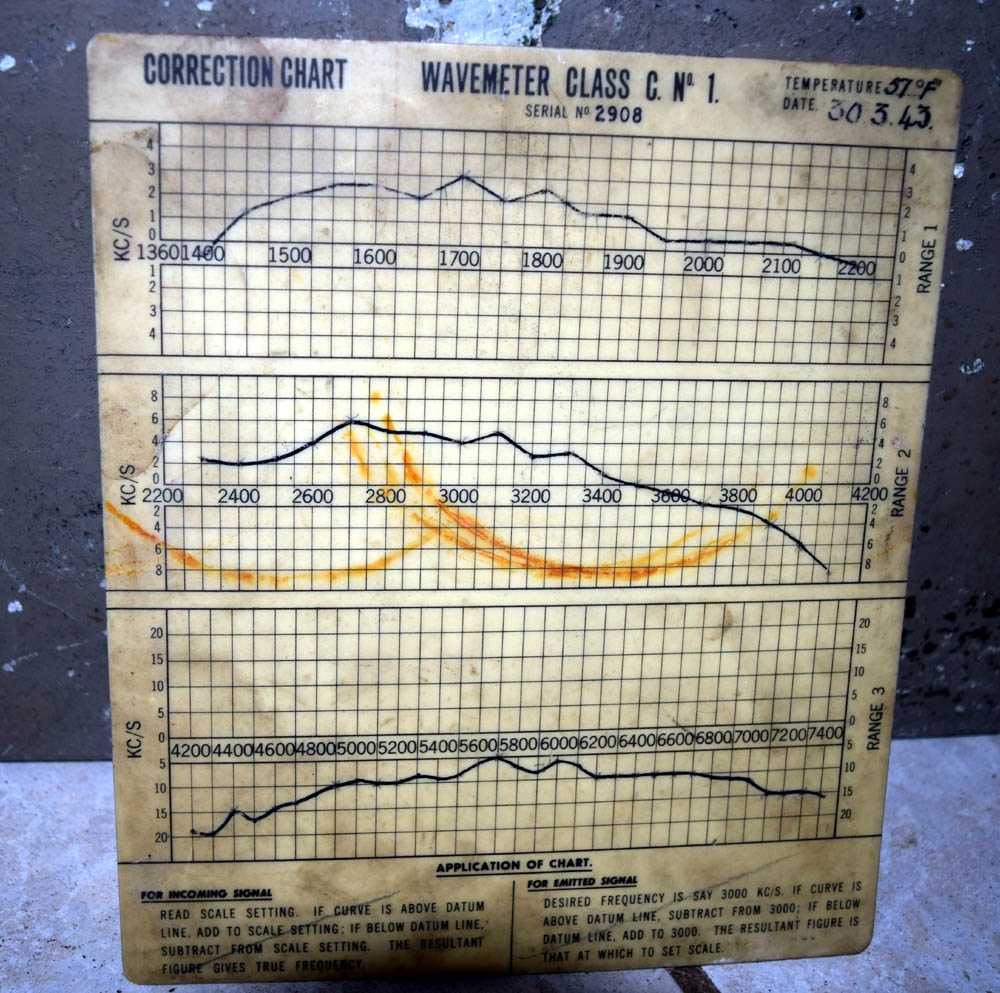

The correction chart has Oct 1, 1940 on one side and March 30, 1943 on the other side. Seeing as how the 11 set was the most modern unit this wave meter was used with, I guess the Brits were still using them for training in 1943.

I got this key off ebay for parts. It's a ZA 3145. What wireless set is it for? I saw one on the net and the brass mounting plate said ZA 4500 which is for an 11 set. I'm assuming the plate had been swapped. I used the plate and finger rest on my other key.
reading through a 'www Royal Sigs etc' doc;
"Key WT 8Amp worldwide survey results" circa 2006.
ZA 3145 shows WW2 lineage....various uses and makers including;
in RCU 'E' for WS19
in YA 8414, Sigs Training Unit
as the key in Key & Plug Assembly No 9.
as the key in Key & Plug Assembly No 2B ZA 4500.
some with some without the finger-plate/skirt.
so you may have your WS11 key just requires the brass plate?
Brent

So the ZA4500 used more than one key then. Four at least! Any of the 11 set period pictures have a key like my original one. I thought this one on an old ebay listing had had the plate changed but I guess not. I guess I have two 11 set keys now but I'll go with the ZA3145 unit.
I'm no expert on keys David, merely passing along info...
but on the face of it, yes certainly more than one WT8 amp key utilised in the ZA 4500 set-up....
the keys were technical progressions on the previous ones, so if one failed it stands to reason a more 'up-to-date' unit would have been swapped for it?
and after 70 years its sometimes difficult to sift the fact from fallacy.

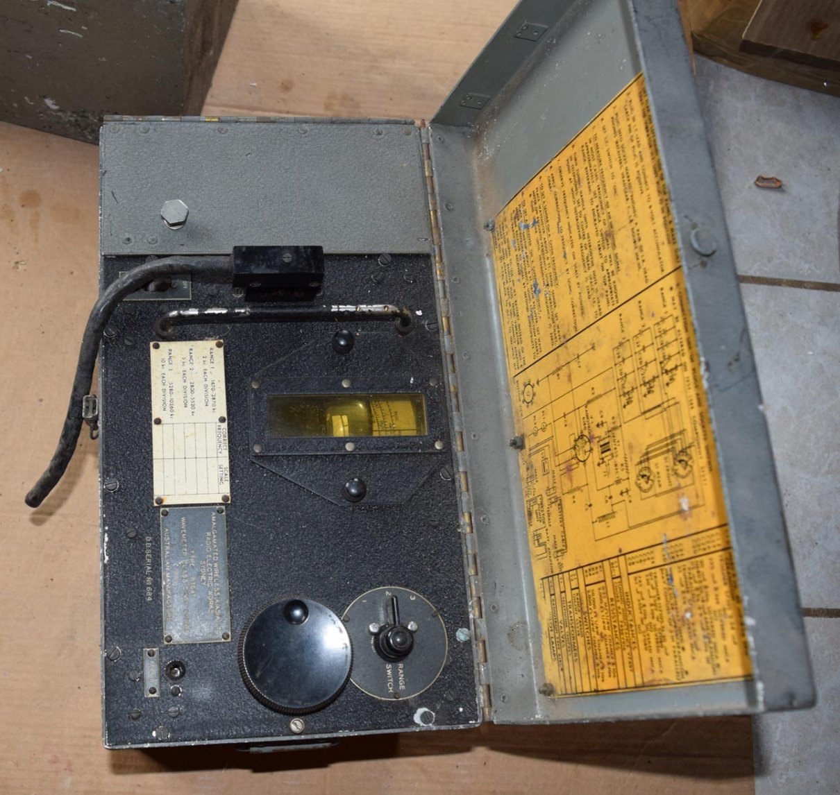

On the wavemaker instructions line 7 it mentions an adapter that stores in the lid for using an HT battery . Here's a pic of the lid with the clips to hold it but what does the adapter look like? Also what would the wire and plug in that picture be for? In the last picture what kinds of end would the wire to the LT battery have? And what would the LT battery look like?
The HT battery adapter is a bakelite block - a socket similar to the one on the vibrator supply but with screws to connect the HT battery to. (I have one in my wavemeter but everything is inaccessible due to an imminent house move.)
Other accessories are a crystal calibrator that fits in the space normally occupied by the spare valve tin. I have one somewhere (but no idea where it is - I will probably find it during the move).
The power cable will probably end in either a Niphan connector, or possibly a 2-pin bakelite push-fit plug to mate with the early accumulator sockets. I think the push-fit plugs were polarised (by having different pin diameters) and restricted to the correct battery by the pin spacing. The LT battery for the wavemeter was probably the 6 volt 16 amp-hour unit that had a wooden case, a niphan socket on the front, and a bakelite socket on the side - that was still in service in the 1960s, I think.
There were all kinds of oddball accumulators: I have the wooden box of a 10-volt 16AH unit (tapped to allow 4 or 6 volt supplies) but the socket has been removed as well as the contents & wiring. That was intended for early sets with 4 and 6 volt valve heaters, and also for the Lamp, Daylight Signalling, Long Range that required the full 10 volts. (I have the lamp, which is why I bought the battery box despite its condition.)
