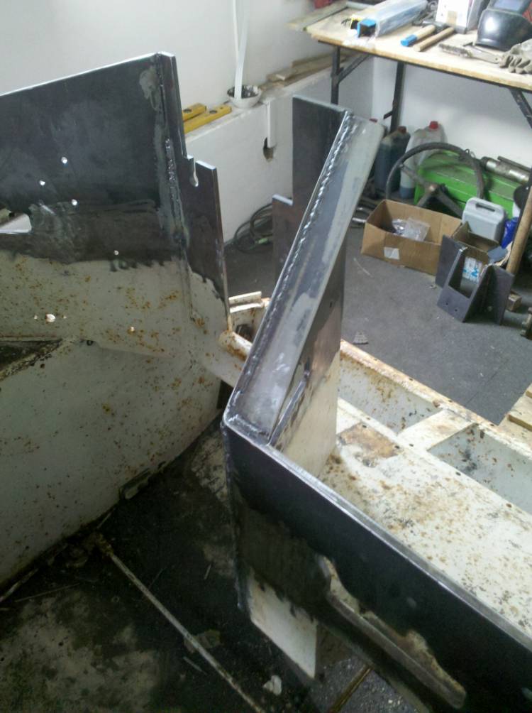

Again - welding, welding, welding
Still not finished, but getting there

Petr,
Great work, I like how you preserve as much of the original metal as possible

Thanks Hanno, yes, that was the goal. Kind of 1:1 scale modeling

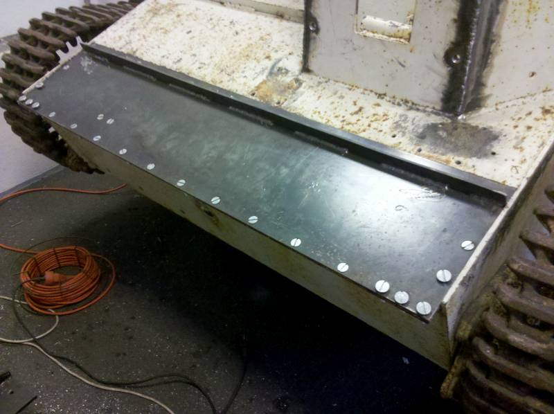

This weekend just made some drilling on the front cover and started work on the steps.
