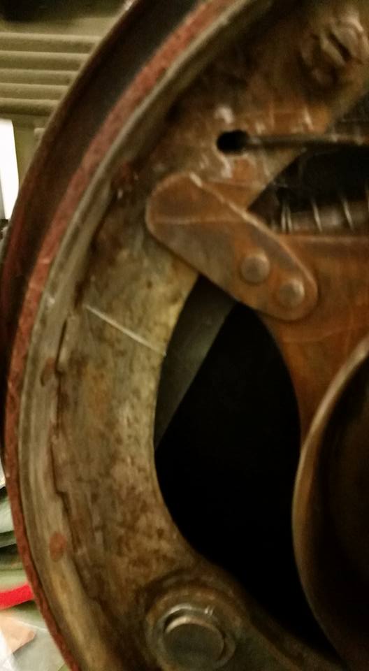

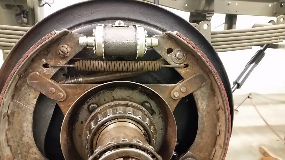

Default Urgent help needed on handbrake installation
Hi Guys
I've been installing the rear brake the past week, and took me some puzzling
and fitting but finally figured it out ...at least that's what I thought..
I can't get the handbrake to work...
One of the reasons I think is the fact that the cable is to long to pull the lever..
However my question : what position should the lever have when in resting position ?? my opinion is that the lever is now to far to the left ???
What is the function of the little spring on the pushrod ??
Please your comments !!! much appreciated

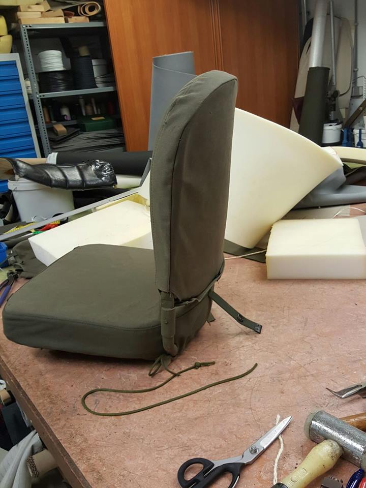

Default And finally got the seats made to it
Originally Posted by 8threcce View Post
Finished spay painting the restored seats today
Here some pics of the new canvas for the seats

Hi
The second hole at the top of forward shoe doesn't show up in my manual. This could be the problem, will dig through my HUP photos and see can find something that might help.
Looks like have new parking brake cables, are you getting full travel? Can you take a picture of the other end? Also did you adjust the service brakes fully and do they work?

Default Here are some photos
Hi
The position of the parking brake attachment point to the forward shoe may be the problem take a look at these photos and see what you think.

Picked the photos which are just after drum was removed, so I know that the parking brake was working as assembled.

Hi
Attachment 81627Attachment 81628Attachment 81629Attachment 81630
Phil
This is strange my set-up is complete the same as yours so the the conclusion should be that I don't get enough travel on the cable
I'll send some pics of my cable

Hi
It looks to me that the link hole you are using is closer to the shoe face and a little lower which would reduce travel of the shoe.
The adjustment for cable travel on my HUP is at other end where the shield for the cable attaches to the frame then also up at lever link going back to the cross bar.
On my HUP I was able to reuse the original parking brake cables, all that needed to be replaced was springs that pull the cable back to disengage the parking brake when it is released.

Hi
Hi Phil
I tackled the problem, indeed I used the other hole and it works fine now!
Hallo Pieter Phil heeft gelijk. dat tweede gat hoort er eigenlijk niet in te zitten. Hebben wij ook niet, net gisteren gedemonteerd!
