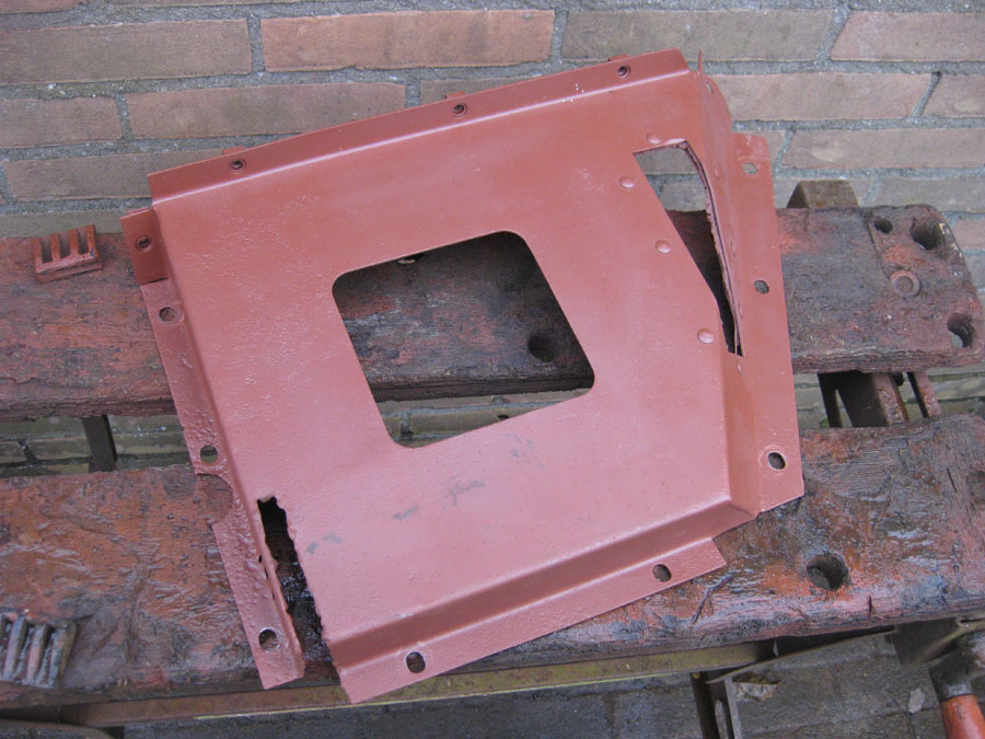

Attached are some pictures of the gearbox cover. Not that I need it anytime soon, but I thought I might as well fix it, when I was dry-fitting the panel in order to determine where to drill the missing hole in the floor.
The gearbox cover was also cut with a torch. I cut the burrs of the edges, welded in some fresh steel and welded the small holes (not rust this time, but holes from the torch) using a piece of flattened copper tube clamped against it.
I still have to find some correct steel rivets to fasten the rubber gasket and plate around the handbrake lever, but first things first.

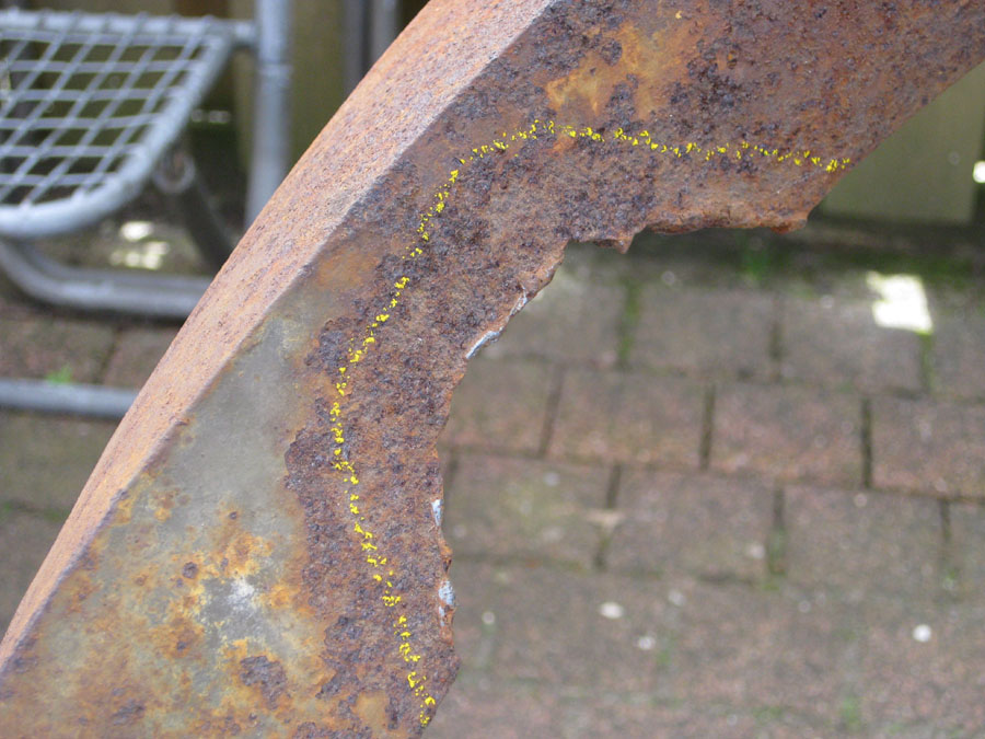

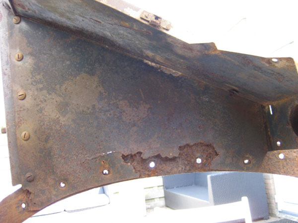

Old 19-08-16, 00:20
Attached are some pictures of the repair to the arch bars of my C8. There were four sections that were in need of attention.....a spot near the steering box (a previous owner cut a hole with the torch), a section about halfway the other arch bar (where the steel was almost paper thin) and the last 20-30cm on each of the ends, where the arch bars attach to the supports under the doors.
I knew this would several hours of welding and grinding, but Dirk at LWD said he might have the solution as they had two sets of arch bars as spare.
Even though the frames/arch bars all look the same, they are almost all different....and the C8 is unique and not shared with C15 or any of it's sisters (difference is mostly in the ends where it attaches to chassis), so on a saterday we had a close look at the spares. After close examination (and info from Bob and Phil, thanks again guys), we found out one was CGT and the other was a Ford one, so no luck.
The Chev right hand side arch bar is different from the Ford one as it has one extra bulge to give some extra clearance for the pedals.
So, it was time to repair my original frame. I started by firmly bolting the arch bars to the chassis.....and adding temporary braces as I was afraid the steel would distort after cutting sections that needed repair.
