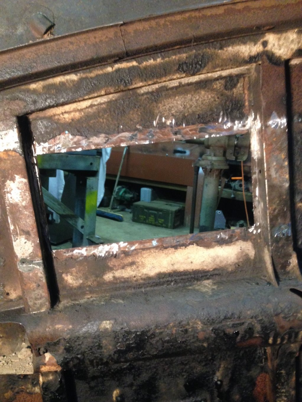

As I was completing the A pillar joints I noticed the 1946 car was finished off with nicely applied lead filler around the door frame and guttering. The wartime Tilllys got no such treatment so I melted all the lead from the entire door frame with the oxy torch. I didn't like the look of the rust behind the guttering so I unpicked the spotwelds and removed the guttering. It wasn't rusted through the body anywhere but I can now clean the guttering in my electrolysis bath and sandblast the body properly before reattaching the guttering.

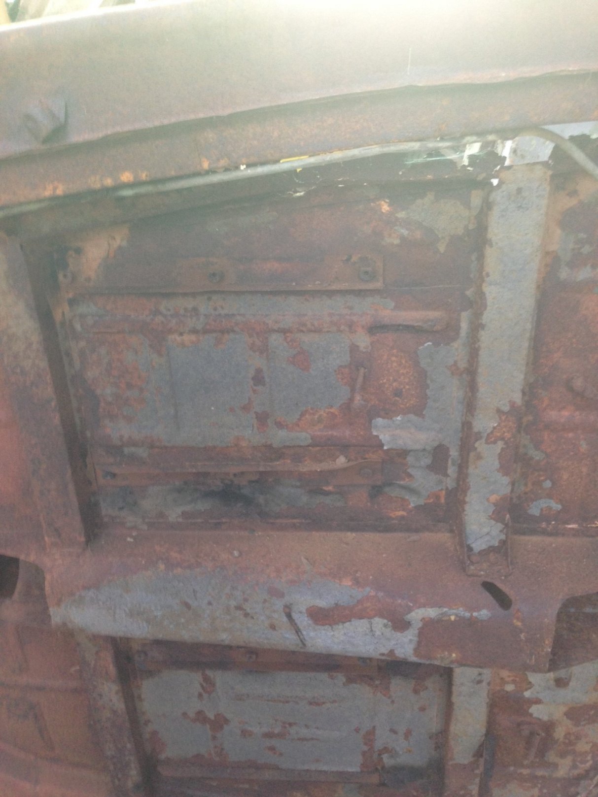

Another area that requires modifying on the chassis is the seat mounts and passneger floor. The car was fitted with an under floor toolbox. Strangely that appears to have been a feature of the prewar cars as well but was removed from the Tilly. The floor was patched over. As the wartime seats were different and simpler the mounting is different but can be simply swapped over from the rusty Tilly. I would have thought leaving the toolbox in situ would have made more sense for a military vehicle.

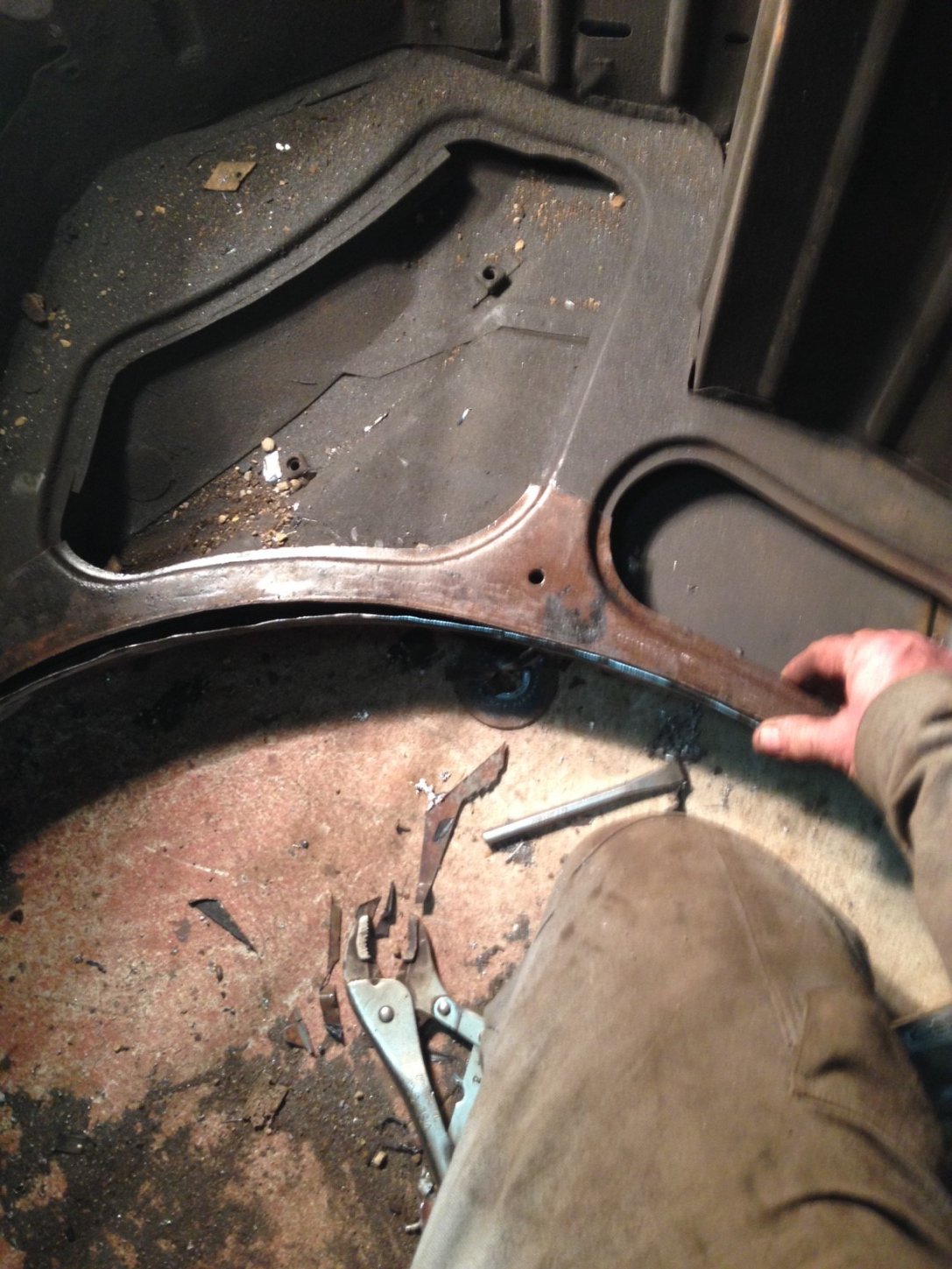

Over the last few weeks I have been getting the car body ready for sandblasting. Among the required mods was removing the under floor toolbox. Simply cut it out, remove the car seat mount and weld in a patch. I used these little devices which are handy for lining up the panels flush with each other before tacking the patch in place and then completing the weld.

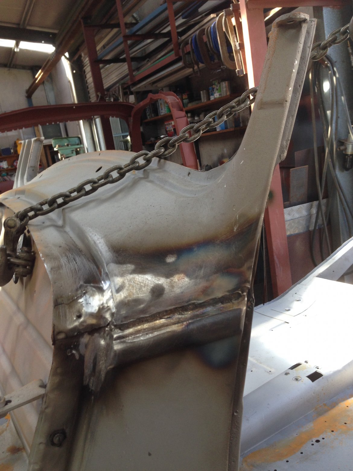

The bottom of the windscreen A pillar is finished off. Small metal sections were required for reinforcing the pillar on the outside and inside where it bolts together.
39787646-11B2-4C43-998A-9E5E1EEBABDE.jpg   23DE8282-B28D-48F3-B408-B4A2AD1E2C31.jpg
