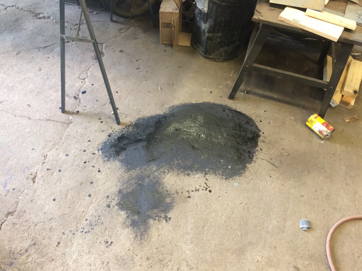

Well I tried the tape up all the holes and pour in a quart trick. I poured in about half a quart when I realized the duct tape I was using didn't hold and I leaked all over the floor. I stopped poring and began rotating. Inside is completely coated in POR15 along with some of the floor.
One door down, one to go (outside that is)

Thanks for the follow up and the picture, how much paint did you get on yourself in the process?
Years ago I tried this trick using LPS-3 which is a cosmoline like rust inhibitor on Jeep Truck doors worked but when ever the truck was parked in the sun it smelled like cosmoline and on a real sunny day in the summer it dripped. The real problem was that tried to weld on door a couple of years later and the inside of the door caught fire. Rest of the truck rusted away but the doors never rusted.
