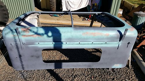

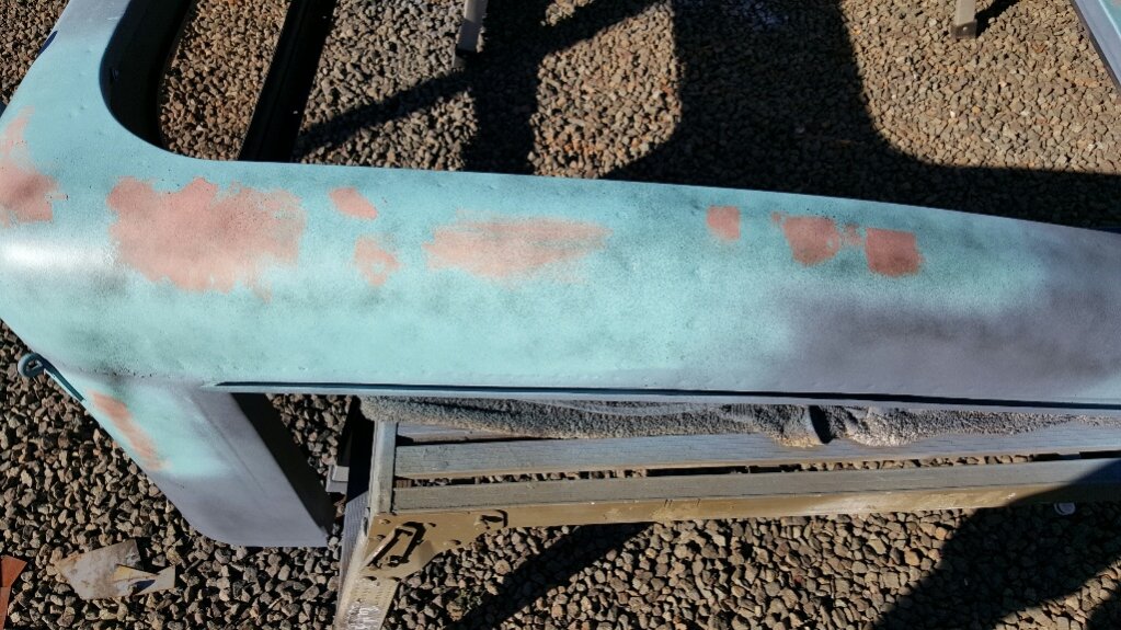

Default Sunshine Roof

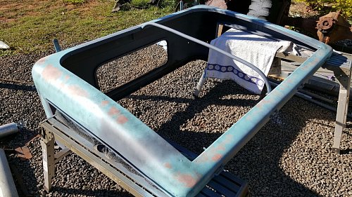

While awaiting 25 pounder parts from several recent purchases, I have returned to working on the truck. More specifically, repairing the small dents on my Sunshine Cab roof. Most of the holes were very simple to remedy, and I even managed to file finish two of them. The others, they required a skim coat of filler. Now I don't know if I've mentioned this before, but I HATE PANELBEATING! I'm not good at it, and I don't enjoy the process. That is partly why this particular task has been delayed for a long time. I knew it would annoy me, and I was right in expecting so.
ID:	83716 Click image for larger version
Urgh, ghastly work! At least it's done now. Before priming, I had to remove the remains of snapped off bolts and the caged nuts that they go into. Most came away willingly, but two had to be enticed off with either grinder or cold chisel. Not every hole contained a caged nut and bolt. Ther are at least 3, possibly 5 holes that just have a plain piece of steel rod. Those would be to assist in aligning the roof with the windscreen frame upper section. I hope all the holes align OK!
ID:	83718 Click image for larger version
This is only the first application of primer and spray putty. It gets dry sanded smooth, then further primer is applied. Any remaining low spots get another load of spray putty and/or wiping/hand putty. I already know two areas which will require a second splatter of putty.
Next weekend the inside should get painted.

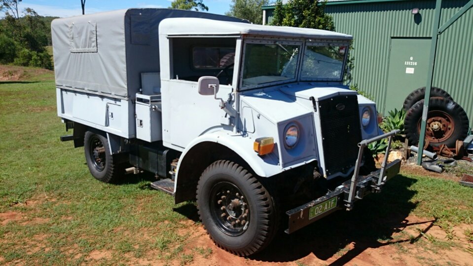

Default Fitting tapered bead tyres to CMP wheels.
Unbelievable! He actually did it.
.....and is happy to do my others as well.

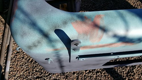

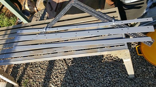

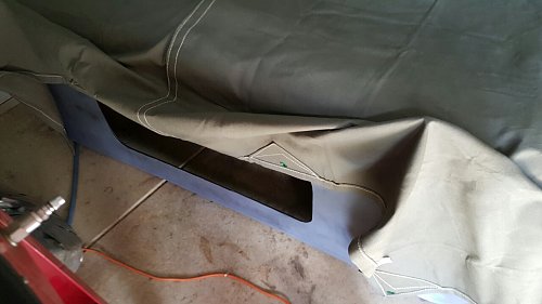

Indeed, David. I think it is time I gave that truck a bit of panel work and a new coat of green paint. My only fear is that the wiring system may not have connectors which will allow me to easily remove the nose panel. I may be wrong though. The former owner is the same fellow who has succeeded in getting the troublesome (for me and every local tyre place) tyres to fit CMP wheels. He is a retired engineer, so it won't surprise me if he thought of any future need to remove the panel/s. An extraordinarily talented man who can do anything he turns his fancy to.

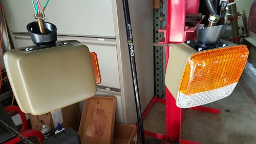

The installing of these wheels (once all have tyres, of course) will make the rest of the vehicle look ridiculous in grey, and the mismatch appearance will drive me to do something quickly, I expect.

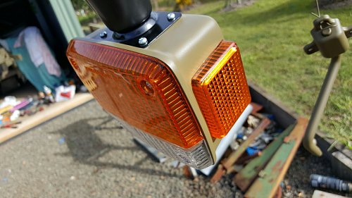

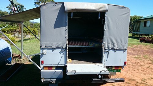

I've been making enquiries about sourcing a quantity of suitable canvas, for rear body, rear window cover, front window bags, mudflaps, door curtains (and it's carry bag), gear boot, cabin roof (read on, for why), and retrim the seats. Naturally, the rear body will chew up majority of the canvas. I will be making those products myself, so I think it best to start on the smaller, easier things first. Painting will be done before all that. That's the easy bit.

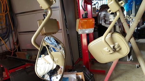

The good news is, I have new sets of side mirrors and front wing lights which are already green, and ready to install once painting is finished. A new set of rear lights are on hand also, but don't require painting. None are original, but are direct replacements for what is already in use. This truck is more of a daily driver than a restoration project. The roof has had some very poor treatment in the past, and lost its hatch, in preference for a badly finished replacement sheet of steel over most of the roof. I discovered some months ago there is water getting through the weld in two places, and it's too much trouble to do further welding to remedy, so the entire upper surface will get a healthy coat of Stone Guard. That'll seal it off. Stone Guard looks horrible, and I'm not driving around with that visible.......so...I plan to attach a raised steel piece from a spare sunshine roof frame I have, and a canvas cover will go over that. From the outside, it will look entirely like a real sunshine roof. A glance upward inside will confuse though. Now you know why I'm comparing canvas prices!
From a quality perspective, this range looks the best I've seen: http://www.wilsonfabrics.com.au/Outd...oductView.aspx
Download the product data Spec file, and compare! They has several thicknesses available, and all are Australian made.

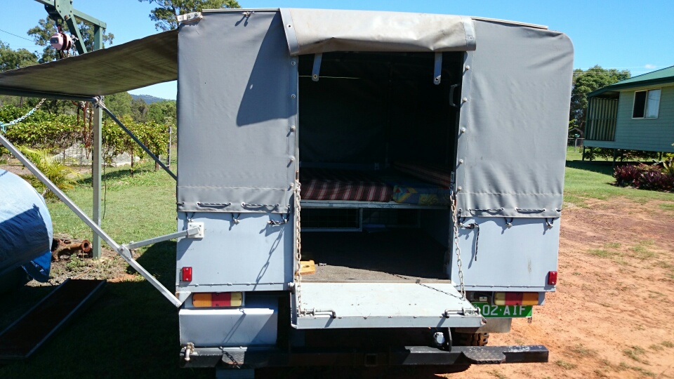

I didnt look too far into the cheaper canvas, because I was afraid it may not be colorfast or waterproof. I suppose if it's cheap enough, I can afford to let it wear out. Perhaps 'weather' may be better word to use. My friend Andy, another MLU member, gave me a nice big dark green tarp that I have been cutting into to make the canvas goods for my gun project. It is nice and pliable, easy to work with (including sew with domestic sewing machine), and it does stretch a little. Guess stretch is a good thing in some instances, not all. The down side is, it freys easily, and is definately NOT colorfast. The freying isn't an issue really. All edges get seamed. The dramatic fading is a concern long-term. Im about to cut a chunk of it out to make a flap that seals the front of a bookshelf I bought to store my tanks. Was going to make a canvas bag to carry all the rechargable battery packs, then I realised it may look like a suicide vest! Good idea, bad time to make it.
You will note there is room for one more tank. Two more if small.

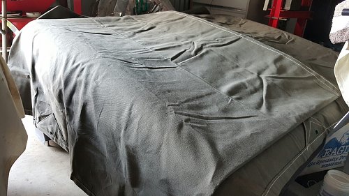

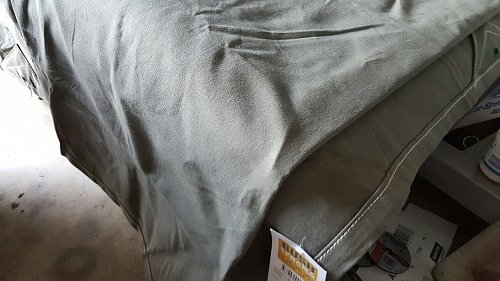

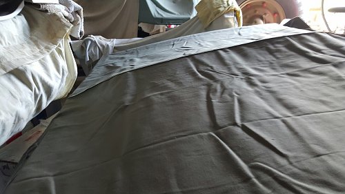

Bought a 100% cotton canvas tarp this afternoon.
Popped into the local disposals store after work, just to look around, and found they have a range of quite suitable, Indian made canvas tarps. Colorfastness (is that a word?) is an unknown yet, but this is as good a starting point, as any, for the roof cover of my Sunshine Cab. Don't think dyeing would work if the damn thing fades too much. The tarp has had a wax treatment during manufacture. The presently primed roof is begging me to paint it, so I've really got to do the canvas bit before I get the paint on, and DEFINITELY before I get the impulse to install the roof onto the rest or the cab itself. Once on, it would be VERY difficult to manufacture the canvas cover. I'm not tall enough to reach that height, and there is no room for scaffolding im my workshop.

Looks good Tony !
I noticed that ALDI currently has canvas drop sheets 3.6 X 1.5 size for 10 bucks , these are plain undyed cotton . These would possibly be strong enough for seat covers if you layered the stuff, eg 2 or 3 layers . You would need to dye them. I use RIT dyes , they work quite well on cotton . Dying yourself means you can choose your own preferred colour !

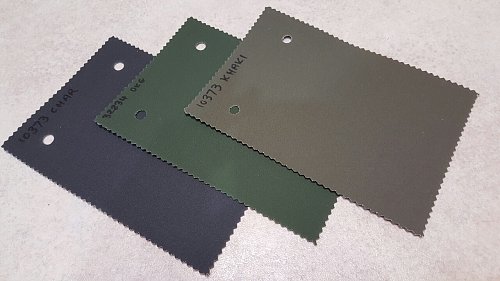

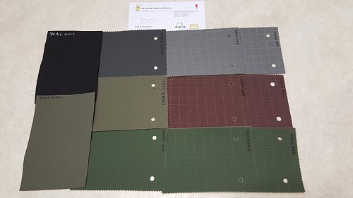

Well, today I have received quite a few samples of currently available canvas types. The modern canvas is dramatically different from the raw looking stuff we are used to seeing on vintage military vehicles, but all types seem to have positive and negative aspects.
The fabrics below, are all from one supplier. They sent me three different types to inspect. The serated edges of the majority afforded me opportunity to test their resistance to tearing, with impressive results.

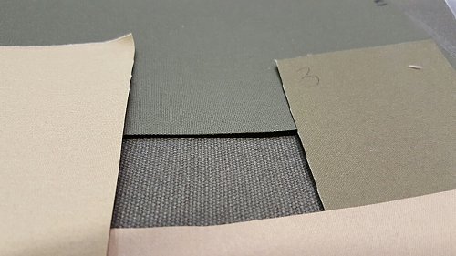

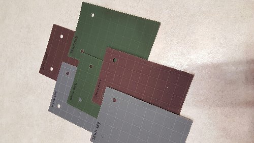

First style, and by far largest selection, are obviously rip-stop material. They are a thick, quite stiff material, and feel like a Poly fabric. Rip-stop isn't for me, because of the chequered pattern. I think you could tie a piece of this to a bogged 4X4 and pull it out without tearing the stuff. It really feels that strong, and I did try (without success) to tear it apart. It just laughed at me! The weave is too tight for canopy use anyway, in my opinion.
Next ones are similar density and weave, minus the tell-tale rip-stop chequered pattern. Poly fabric again. It looks good, and would be worth considering for some projects. It is very stiff though, so you may not want to use it where 'billowing' canvas look is appealing. This stuff wouldn't flap much in a tornado. Probably good thickness for home awnings, vintage caravan annexes and squatters chairs. You foreign folks, look up squatters chair in google. As with the previous selection, weave is much finer than military canvas of decades ago. This type also mocked my puny attempt to damage it.
These next two are similar in appearance to the second photo BUT they are thinner material. I would be quite happy to use this for my side curtains and similar sized applications. It would keep it's shape nicely, in uses where that would be desirable, but this fabric is sufficiently thinner in feel, making it a better choice for a range of applications. This one ticks the boxes for any future side curtain manufacture I do. Remember, I still have the dismantled original curtain/s used as pattern to have a pair of new ones made, to copy from. I'll need to improve sewing technique before tackling those. The pair I had made for the restoration truck a couple of years ago were probably done in this material. A visit to the workshop tomorrow afternoon will confirm that, but I'm fairly confident. While maybe not the range of colors to choose from, I wouldn't be upset with using the one green shade shown here. There may be other colors available, but I didn't get them in the batch of samples I received. In keeping with the trend, material has the same feel and look of the previous two types, so I'm confident they are synthetic materials also. Oh, and I couldn't tear these buggers either! Is it too much to ask that I manage to rip one sample, just a little bit? Apparently it is!
This last image shows all the samples together. It's an impressive range. All are waterproof, surprisingly tear resistant, and none could be persuaded to fray. While no description accompanied my samples, I'm prepared to wager they are all very colorfast. Can't say that about the cheap, 100% cotton tarp materials, manufactured in India and the likes. As I said, all have positives and negatives, but if you're looking for longevity over replication of exact appearance, these will outlast religion!
I'll post another suppliers range in next posting, along with some visual comparison between both lots and the Indian/Pakistan made cotton canvas currently available everywhere on earth.

Might also be worth seeing if you could get samples from any supplier of the 100% cotton items in as heavy a weight as possible. I think the original wartime stuff was in the order of 18 to 16 oz. I don't think they worried about thread count for that stuff.
Different mills probably have different production capabilities. Some can probably waterproof and mould protect on site, but most may not. Any dyed canvas is going to bleed like a stuck pig if it is not waterproofed, so the fact it might bleed just means the cloth has not been treated in any way. That probably opens up canvas products to a larger potential market for sales. If the buyer happens to be a tent maker, they may purchase bulk canvas in any colour and waterproof etc themselves, have it done by the canvas manufacturer or outsource that part of the work to a 3rd party company.
It might be cost effective to get a 100% cotton heavy weight canvas untreated in the colour you want and then apply suitable coatings yourself.
Also, I wouldn't worry about shrinkage too much. All canvas shrinks when wet, Even the treated stuff. It's the nature of the beast. My M38 top was a Beachwood Canvas product out of the USA. It was a nice relaxed fit in the summer heat and would snug up a bit in colder Fall/Winter weather. But get it wet in the Summer and it would tighten up so much a group of Taiko Drummers could have performed a concert on it! Same thing used to happen with my M37 top come to think of it, though not so much the end curtains for some reason.
You could always stitch up a one foot square of whatever you end up working with, soak it, toss it in the sun to dry and see what sort of shrinkage you get before and after waterproofing. That would give you a good idea of the wiggle room you would need to factor in for the actual parts making.
Keep up the great research!

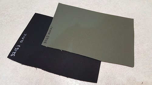

This material is different again from the previous post. A considerably thinner material by comparison. Fine weave again. Not 100% cotton. Nice and strong is the theme with the modern materials, and this is no different. I did get the impression this one could tear, and I didn't test that to destruction. I only have these three narrow pieces, and did not want to destroy one.
ID:	85264 Click image for larger version

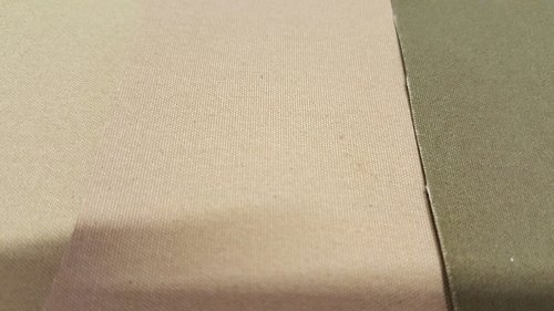

This stuff is possibly woven even finer than the ones examined earlier. I don't know where this material would be best used, if at all. Yes it's colorfast. Yes it's completely waterproof. It's also OK colors. My hesitation is the thin gauge, mixed with the fine weave, makes this feel kind of like paper. Even multiple thicknesses, like would be needed to make side curtains, may look too thin. Although very thin, it is not as flexible as I would want, and I don't know where this material would be used on restorations. In all honesty, I wouldn't use this type.

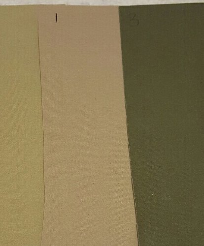

Here is a closer view comparison between new canvas and the much more coarse 100% cotton fabric coming out of India & Pakistan. If a gun was held to my head, and I was forced to use modern fabric, I would prefer the canvas of second last photo (showing just khaki and black) from previous post. You can see from the photo above, that there is a huge difference between coarse cheap cotton tarp material and the modern, too fine looking varieties. I'm in no doubt modern fabric is MUCH better wearing, weatherproof, and colorfast, but I believe the desire for wider range of uses has forsaken it's widespread use in military restorations.
For my needs, the coarser, (and potentially trouble prone) cotton canvas from India just looks so much better insitu. Provided you are aware of it's limitations, you can work around most areas of possible future issue. For example, yes it's gonna fade if left outdoors forever. So don't store the vehicle exposed to the element all the time, without some additional form of protection......... like a poly/plastic tarp over the areas of concern. Better still, give the poor old thing a sheltered home. Also, the cheap canvas is much more likely to fray around the edges, and avoiding this is simple. Make sure all edges are hemmed well, and take care with handling the product until this is done. I'm quite sure the original canvas of 70+ years ago wasn't given the same care and attention we provide now, so ours will have greater longevity, I hope!
While I am appreciative of receiving the canvas samples for inspection, their use in my applications is limited. I would happily use it on a number of areas on my grey truck, but I can't see it getting much of a look with the restoration vehicle. It doesn't give me the right visual appearance, I'm afraid. I know there are countless other manufacturers and types of canvas products which I haven't had opportunity to inspect, and I expect those too would be aimed at a market that clashes with the look and feel we are wanting. As long as the factories in second (or third) world countries are pumping out the coarse 100% cotton material, that will most likely be my choice. My truck will always be garaged and protected from the elements, so that makes a range of complications with cheap canvas nul and void. The propensity of cheap canvas to stretch, or indeed tighten under certain circumstances, can be made to work in my favour, provided I am aware of this and make allowances at time of fabrication and practical use.

Had a play around with my canvas tarp, draping it unceremoniously over the sunshine cab roof.
ID:	85318 Click image for larger version
These 2 photos are taken from front driver side corner. The 'tuck' under at front, is how the canvas will sit over the metal piece that runs across and tightens into place with two brass wingnuts. I hadn't realised there was a very obvious seam down the middle. I don't fancy that at all. Apart from the seams having highly visible thread, it looks ugly to have a line right at the highest point, where the steel tube will hold it in prominence. Grrrrr.
ID:	85315 Click image for larger version
The metal parts that form part of the rear cab window are now primed and ready to be incorporated into that project, which is the next thing i will tackle. I'm working my way up to the cab roof cover!

If you feel that the Indian canvas is not strong enough . Maybe consider two layers of it sewn together ? Nobody will notice any difference and it will have a heavy thick original appearance
  #1708
Old 25-09-16, 14:05
I think it will be OK if I use strong thread (which I already have) on all stitching, and double seams all round. If I make allowances correctly, the slight stretch will work in my favor, because the raised up tube in the middle means without stretch it won't sit right at the rear. The tricky bit will be getting the stretch tension just right. If I am out by a little, that can be corrected, I think, buy the tension on the lacing through eyelets down at the back.
I'm happy with the cheap canvas. It looks right, when viewed in person, but when looking at the photos I took today, it looks all sort of wooly and overly fuzzy. In reality that's not the case. I also see the photos have highlighted very minor defects in manufacturing where a lump may appear in the weave. To be honest, I don't think the original canvas would be any better quality, so it's probably fairly representative of how it once looked, all those decades ago. Looking at examples in museum photos, theirs are rather poorly fabricated and sewn. If I get it taut and fitting well all round, I'll be alright with the result.
Incidentally, I made a remark some days ago, about having leftover material to use for my 25pdr spares roll. Noooooooo, there won't be enough for that or anything else larger than a gear boot cover perhaps.
  #1709
Old 25-09-16, 14:42
Posts: 6,040
Default shrink
You know this already. Before you do any sewing , throw the canvas over the washing line outside, give it a good soaking and let the sun dry it , it will shrink about 1" - 2" all round .
