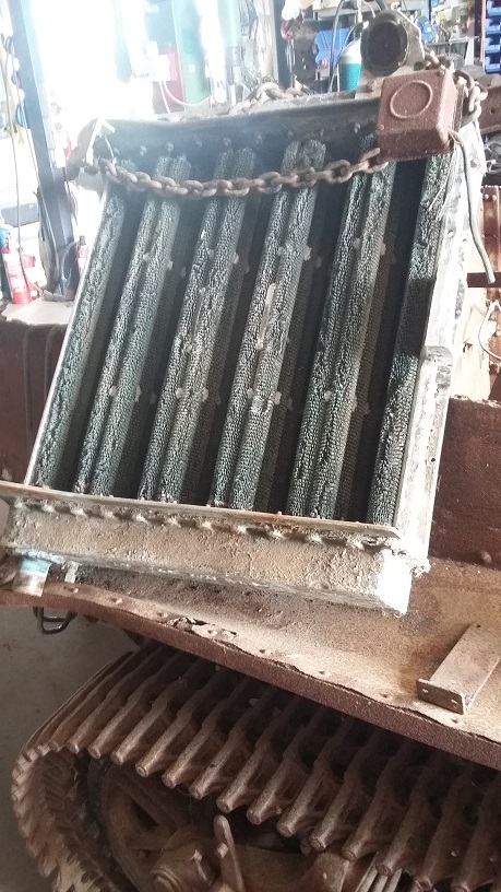

A couple of the seats and I have a complete radiator as well.

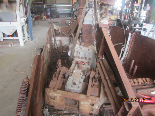

Hello one and all. I'm trying to get time to work on these tanks so here's where I am.
I have stripped what ever I could out and got the drive train out as well.
I was a little disappointed when I lifted the trans up I found a few lumps of powdered casing underneath so that just means more work. The engine however appears to be good.

Posts: 1,810
You can see the damage that has been done over the years but I'm sure it can be repaired.
I can see the gears amongst the crap and believe it or not I don't think they are that bad. But I could be wrong.

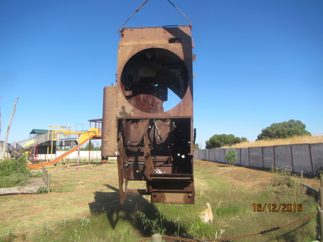

I resurrected my poor old crane which hasn't been started for a long time but all good (Perkins engine ). The bottom of these tanks needed a really good high pressure steam clean which blows out everything including chunks of rust.

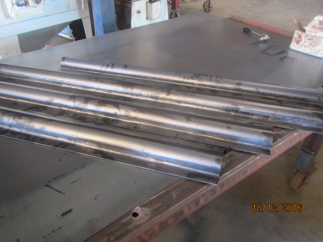

The other photo's were taken a few days ago. All the cross tubes that protect the axles need to be replaced so I have made a set of crude tooling. The top one is a hydraulic cylinder of the diameter required and the bottom one it a relatively thick piece of water pipe with the correct inside diameter. I have just welded other pieces of flat bar for some load transfer during pressing.

A few more strengthening pieces and ready for a test press

I tried a thinner piece first with excellent success then a piece of the correct thickness required and the only thing I will require will be some lubricant during the press process as it has to pull the material in from both sides at the same time to bring it down into the bottom form. It just needs to be able to slide but I know it wont be a drama. I only need to press 4 of these so tooling neatness was not a priority and I don't think I need to make any for stock unless there is a few more of these around the place
That's it to date.
Colin

Thanks Wayne, I pressed out the four that I need and my press is not really powerful enough to do it as it is only a 40 tonner. I had to use lots of oil and press them in stages which stretched parts of the bottom die. I would think It would take a 60-80 tone machine to do a single consistent pressing. But it worked with some persistence and the dies are now scrap.
