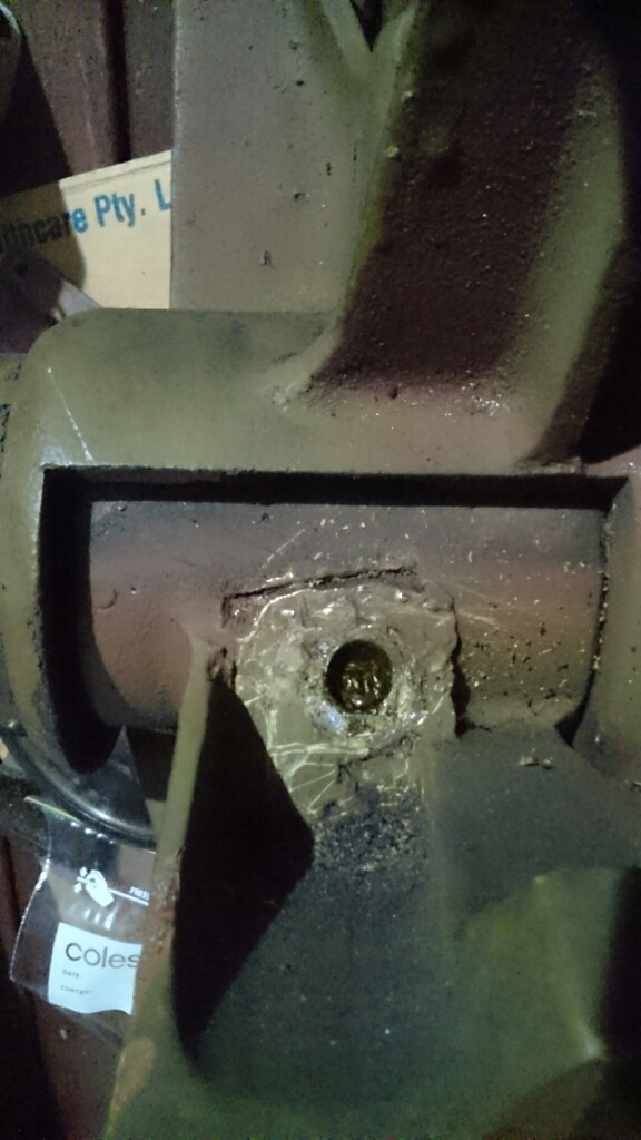

The thread on lower end (where silver bolt is sticking out) is too wide for use, so I plan to find a suitable bold to insert firmly, cut flush with the botttom of the linkage, then drill & tap to the correct thread I need.
Look up Keensert, they are a thread repair system that might do exactly what you need if the inner and outer threads work out for the size you need. Once installed properly they will not come out. Helicoils serve a similar purpose but are less robust and should never be used with thread locker.

Hi Russ,
Not heard of that product before. I've started looking through their website, or a site selling their parts anyway.
  #203

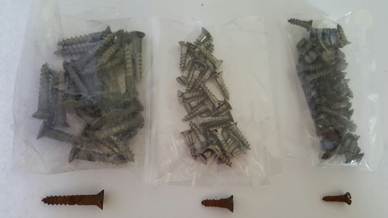

My screws arrived, and I've been busy splashing gun blue over them.
The single ones at bottom are the old ones!
Getting there.

Ah, the memories.
ID:	87133 Click image for larger version
Stencilling next, then attach the lid braces.

The very bottom has suffered from considerable exposure to water at some point in it's long life, but fortunately the shape of the corrosion has left good perch for me to graft a replacement section on the undamaged casting. I think I'm up to the challenge. Quite looking forward to taking on that task. Very grateful the corrosion has not travelled as far as the clinometer mounting. Replicating that would be a cow of a job.
ID:	87289 Click image for larger version

Some pieces need a little more work than I had originally thought, because some earlier owner had taken the whole 'deactivated' theme rather too far for my liking, and applied lumps of weld to defenceless bolts, nuts, etc... Not so much an issue if doing a liquid restoration, but I want to have everything working as it should, so everything must be able to come apart for cleanup.
The following photos are a few days old, with the first one being most recent of those. Pretty much everything is apart now. Even the abortion that you see in 2nd photo below. There was a nice big blob of weld on that one, and the grease nipple had rotted away long ago, by the looks.
ID:	87518 Click image for larger version

My welder friend assures me he can weld up the bottom of the casing, where serious corrosion has eaten away a decent chunk of metal. I think we will probably weld a 'reasonably' accurate copy of the lower portion, and then use filler to finish and add all the finer details.
Quite a few pieces are brass or bronze, including a large part on the rear of the assembly. All going well, I intend to retain that in unpainted condition. Possibly even polished up. I know it's not as it would have appeared in real life, but these things are such a piece of art in their own right. Would be a pity not to emphasise that, I think.
