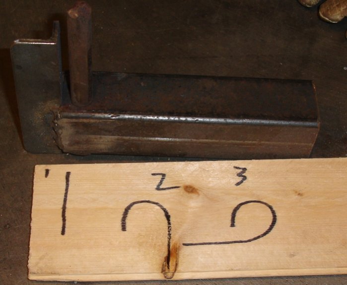

Default Hinge jig
The jig used to bend the hinges was made from scrap bits of angle, rod and plate welded (crudely) together. The photos show the jig and the bending sequence scribbled on some wood that has probably since been fed to Lucifer. The bending had to take place in phases as I couldn't work fast enough the do the full bend in one heating of the stock. I was using an oxy-acetylene torch for the heating. If you have access to a forge, it might work better.

Im just curious on the actual process. Do you fix the jig in a vice, then insert the metal strap in from the top and flush with the bottom edge of the angle iron? Heat and bend as you until the strap is now against the long side of the angle iron?
Is the diameter of the rod on the jig the same diameter as the finished inside diameter of the hinge?
Old 13-12-16, 01:18
The jig was in the vice. I preheated the hinge stock before inserting it as you described. My thought was that I would limit the heat getting into the jig to reduce distortions. Most hinges took a second heating.
The jig rod was the same size as the hinge rods but to ensure a bit of clearance I did run a 33/64" drill down the barrel of the freshly made hinges. some didn't need any material removed, some did.
