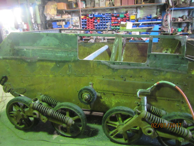

colin jones's Avatar
Posts: 1,810
That's about all the side steelwork done except for the rivets. All holes are drilled and I'll try and get it riveted tomorrow.

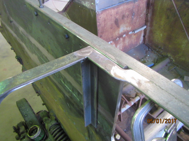

Old 05-01-17, 11:49
Posts: 1,810
Come on Howard, be nice now! There goes the Xmas list.
I'm in the process of replicating the exhaust cover and they certainly went to a lot of trouble.

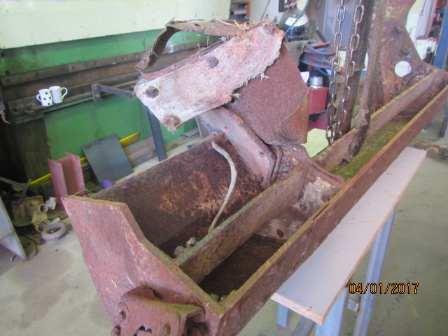

Posts: 1,810
I'm ever so glad to have an original to copy.

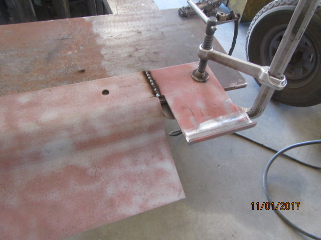

Posts: 1,810
The part I made today is at the front of the engine and under the air scoop. It is quite a heavy little cover and made of some 6mm and 12mm plate. My press brake didn't like bending it at all so I had to form bend it a little at a time. Luckily it is only a couple of foot long. It took a wile to get the convex bend and concave bend in the exact location so I made the plate wider than required and cut both sides after I has happy with the profile.
