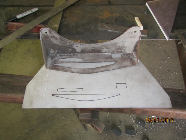

Time for the other side which created a problem as it is made from 14mm thick steel and it is not available, only 12mm & 16mm which I had both of. my only option was to cut the pieces to the correct size and them mill them down to 14mm. That was no fast process

Just some more of the same process.

That's all of the upper plates cut and test fitted.

And a shot of the inside. Interesting point is when I was cutting the original armour, I thought it would spring open but it actually closed on itself so I had to keep a wedge in it so my grinding blade didn't grab and shatter. Every now and then I just hear a bang when I came across an existing crack.

I welded the graft plates and had some trouble getting them to line up perfectly as you just can't blend the join if the alignment is out. I thought I would just show how I got some serious leverage easily as the plates are over 1/2" thick. I also concentrated on the mud guard as well.

There were some support brackets to make which I had to go and get the right size 40mm x 8mm. I did a couple of bends in the hand bender and then made a jig.

After I made the jig it was just a repetition to get them all the same. I used heat to get the last couple of bends, cut the excess by hand, welded the joint and ground them off inside and out. Test fit all OK.
