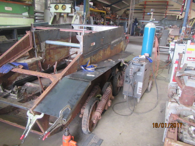

  #72
Old 18-01-17, 08:25
colin jones's Avatar
Posts: 1,810
I welded the graft plates and had some trouble getting them to line up perfectly as you just can't blend the join if the alignment is out. I thought I would just show how I got some serious leverage easily as the plates are over 1/2" thick. I also concentrated on the mud guard as well.

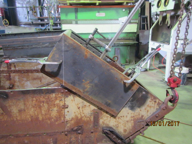

  #73
Old 18-01-17, 08:27
Posts: 1,810
There were some support brackets to make which I had to go and get the right size 40mm x 8mm. I did a couple of bends in the hand bender and then made a jig.

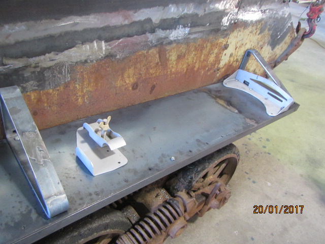

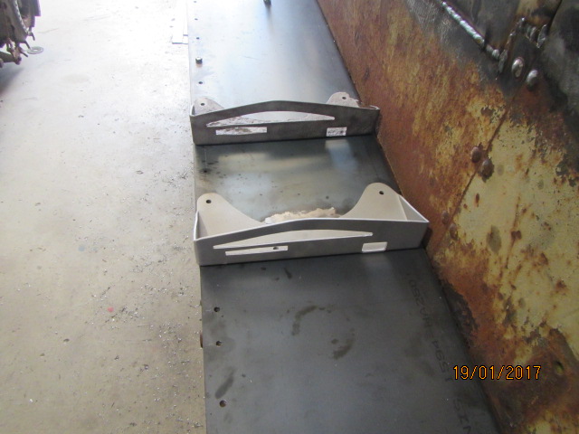

  #76
Old 20-01-17, 09:21
Posts: 1,810
Thanks Jack, there is a lot of work to do any of these as you certainly know.
I made some brackets that go on the mud guard. Not a important job but I just thought I might as well finish the guards totally.
  #77
Old 20-01-17, 09:24
Posts: 1,810
The bracket are for shovel, crow bar, towing chain/Rope. Again time consuming things to do but how lucky am I to have them to copy.
