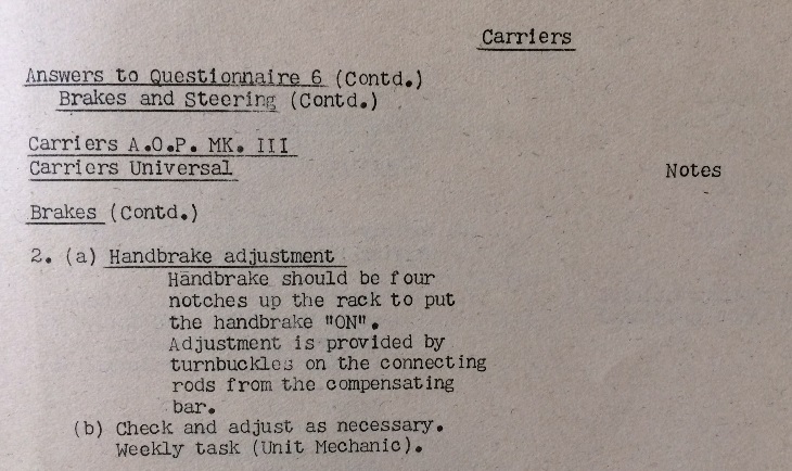

This is the handbrake control bar, part number CTL 4050.
Handbrake should be four notches up the rack to put the handbrake "ON".
"Hand brake control bar should be free on hand brake lever so that the lever will not be caused to creep "on" by use of foot brake."
