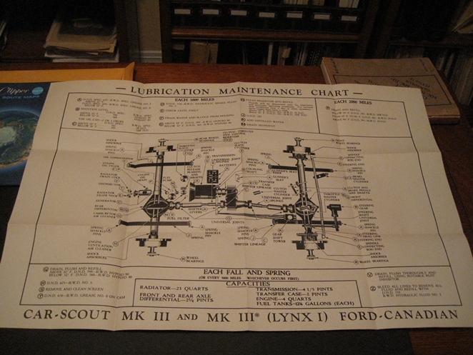

Default Lynx Stowage & Lubrication diagrams
Rick, and Peter,
The stowage and lubrication diagrams (one of each) are about 24 x 36 inches each in size and come from the pockets at each end of the Lynx maintenance manual. The local Staples store can copy that size. Cost is $6USD each.
If folded as per original, the postage to Australia (large envelope - standard mail not trackable) would be about $10USD. Have not checked re postage cost to Canada. Rolled would be more expensive and requires the cost of a postage tube as well.
If either or both of you wish to proceed (or anyone else for that matter), PM or email or contact me via the contact page on my website at www.michaelkcecil.com

Finding a scanner that will take a 33 x 22 sheet is the problem: I found a copier locally, hence the offer to copy & send.
Note: these are Lynx Mk3/Mk3* diagrams, not Lynx Mk2.
