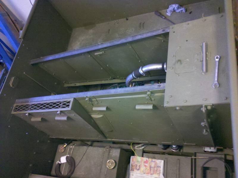

Started work on the engine compartment covers.
UCw Mk.III

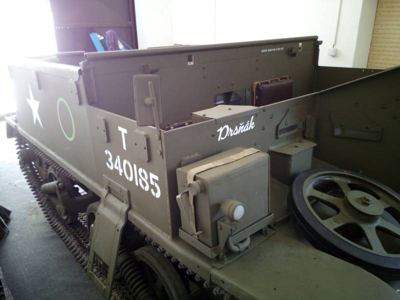

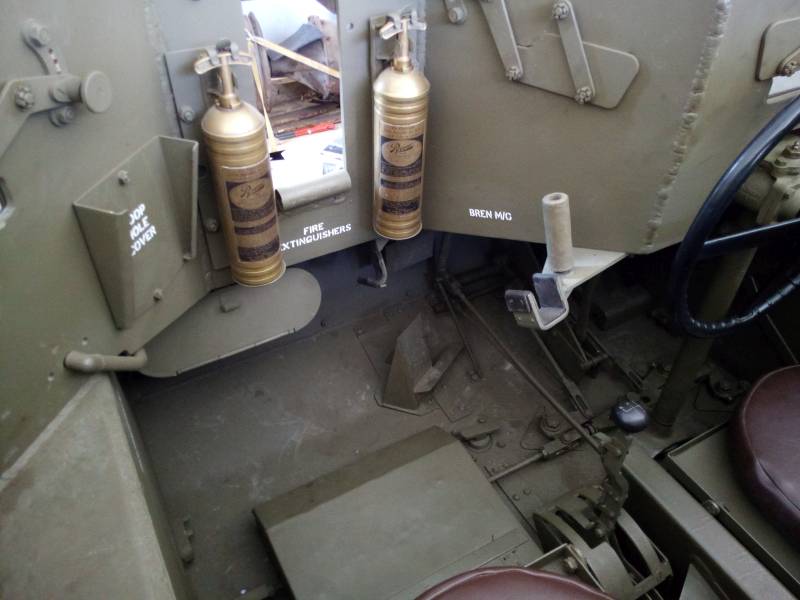

Back is almost finished, few new parts fitted. Also took her out for a while
