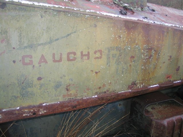

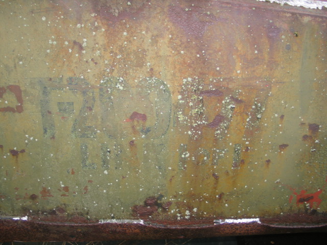

Very fortunately, this still retains paint markings giving the Census number and Tank name:
Tank Name - "GAUCHO"
Census Number - "T-289477"
I've been advised that this vehicle served with the Canadian 21st Armoured Regt (Governor General's Foot Guards), Canadian 4th Armoured Div from July 44 to July 45.
On that basis, it will be restored as such... just need to start gathering info to get the markings correct.
Still on the hunt for 17pdr parts... but I do now have the 17pdr parts lists and the Service Instruction Book... so things are slowly going in the right direction.

Very fortunate these markings survived, but where did the information re. the Governor General's Foot Guards come from? Just asking because there is a lot of misinformation about.
The assumption this vehicle was with GGFG is based on this document from the Canadian Archives:
Am assuming that the bit (Ex-21-CAR) indicates the vehicle came from 21st Canadian Armoured.
