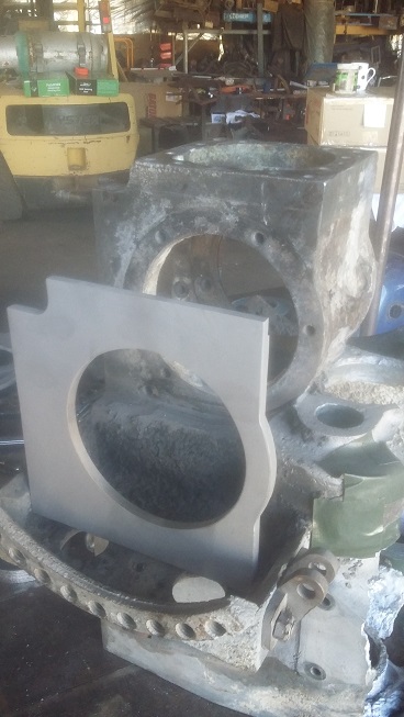

This part is the centre of the trans in between the gearbox and the angle drive box. I have made up some aligning tubes of specific length and distance apart.
  #125
Old 05-04-17, 04:39
colin jones's Avatar
Posts: 1,810

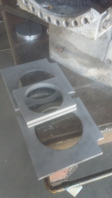

Obviously the location of the bearing housings are critical and I should be very very close to the original location. I am constantly machining up plugs, spacers and anything else I need to obtain accuracy.
  #126
Old 05-04-17, 04:42
Posts: 1,810
The gear that fits into the housing here must be some kind of support idler, as it has a small gear that runs of the main bottom shaft but does not move and only ever runs on half the idler gear. I assume it served some purpose.
  #127
Old 05-04-17, 04:44
Posts: 1,810
The housing is complete and the gear fits really nice and spins well. I just need to get it to fit into the jigsaw and remain aligned. Matt,, sorry I never answered your question of why I'm using steel. There is a few reasons. First is I have lots of different sized on hand, I find it easier to work with than alloy. It doesn't damage in the lathe chuck and you can give it a hammer with out distorting it. Welding is so mush easier as is shaping and I'm much better at welding steel than aluminium.
Colin.

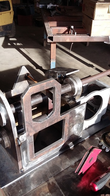

Thankyou Petr. Now that I have put my shaft aligners in and the bearing plugs, it all comes together really really well. Basically, if the shafts that I made line everything up and the spacers are correct then there is every chance that this fabricated gear/diff housing will work. If I get a chance over the weekend, I will clean up the gears, shafts and bearings and install them for a look see.
20170407_161932.jpg   20170407_161941.jpg   20170407_162150.jpg   20170407_162158.jpg   20170407_162304.jpg

I have now got the main box welded together.
20170409_094812.jpg   20170409_101218.jpg   20170409_101241.jpg   20170409_101614.jpg   20170409_103618.jpg
