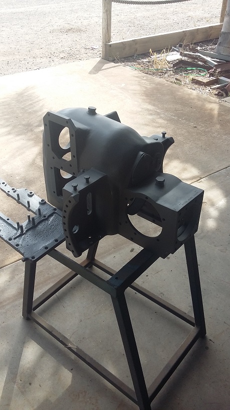

The box is totally finished including the dipstick entry tube and it's all primed and ready for a coat or two of silver enamel.
I'll give you the answer to the above after I give everyone a bit of time to put their thinking caps on and yes, I did do mine on the lathe.

Geez Colin... that looks brilliant, an amazing bit of engineering.

Thanks Wayne, I'm pretty happy with it.

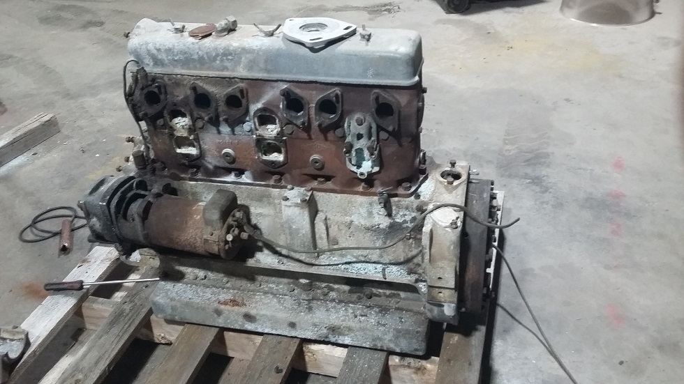

A couple of other parts I have made and a picture of one of the steering clutches which is in very good condition. I also took a few parts of the engine and again in very good condition.

It's incredible that all the bots that hold the inlet manifold on came straight off and so did the exhaust nuts as well, although they were brass. The starter bolts came off and the water jackets that were almost gone just about undone also. I think they used some copper grease perhaps. Anyway it's ready to go and get rebuilt. The sump is in great condition so I am really hoping that the internal components will be also. The engine rebuilder wants to disassemble the engine himself so he can inspect and familiarize all the parts and the timing aspect as well. I will be looking forward to getting it back as I'll have the trans all ready to couple together.

I already have a hobby thanks Tony Here's the photos Lynn and also of the clutch from the engine as well and that is in really good condition too.
