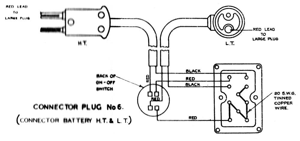

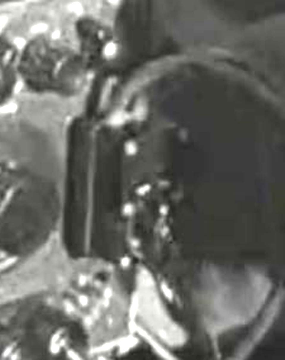

I took some screenshots from that Erecting the 11 Set video showing the dry cell battery setup. That connector plug no 6 is from the Brit manual.
The soldier on the left has the H T unit and on the right has the L T unit.
It looks like the connector has a switch built in. Both battery units use Niphan plugs as well. That makes 8 male Niphan plugs and 6 female ones on one complete vehicle setup.
Screenshot_9.jpg   Screenshot_12.jpg   Screenshot_7.jpg   Connector Plug No 6.jpg   Screenshot_7l.jpg

Here's the only other 11 set pictures I have that show those dry cell batteries. They must have quit using them fairly early in the war.
The H T accumulator looks to be about 14" square and about 3 to 4 inches thick.
