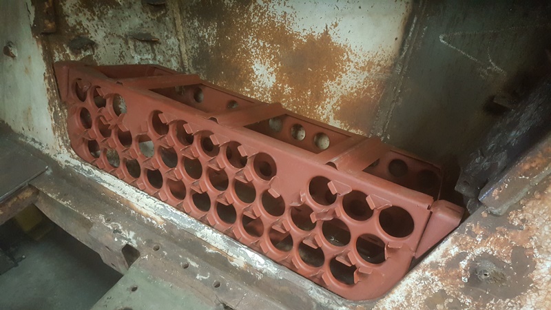

Hi all,
Things have been a bit quiet with the restoration lately due to commitments with other projects, but I haven’t been completely idle and it is still progressing.
The work on the hull is continuing. I have a few parts arriving next month so will have bit of welding to do along with a few other things I am doing. I have the second headlight guard and the first aid kit bracket to be welded on, as well as some new exhaust mount brackets.
The rear engine support hull cross member had been removed at some point so I had a new piece of steel folded up into a channel type profile, which we will weld into place.
Unless I am lucky and find a front engine mount cross member (shown in the pictures) somewhere, I will need to get another piece of steel folded into a channel type profile, which I will cut and shape to form the cross member for the front engine supports.
I was a bit lucky with the oil can brackets for the engine bay. I acquired a good one (thanks Bill) and had another one (thanks Mathijs) for which I have fabricated the clip.
The tool lockers are nearly done. I had two in reasonable condition along with three that were really only good as donors. The reasonable ones looked like the moths had got to them though with lots of small holes in them, so I had to splice good bits of material from the other beaten up ones into these two. I found though that the pressed pattern in the donor tool lockers had a different spacing to the other ones, presumably from a manufacturing change, so I didn’t have as much good donor material as I thought. They don’t look too bad now though and they shouldn’t need much if any fibreglass.
I resurrected from the dead the two tool locker lids I had. One looked like it had been run over by a Sherman tank and the other was heavily corroded in places. Even after lots of straightening, the mangled one is pretty marginal really, but I’ll see how it looks with a blast and paint. I have sourced two nice looking repro lids from Belgium and they are on the way here, so that will complete the set.
While these wee jobs are going on in the background, I have started work on the turret. The turret was obviously a range target at some point and has a number of bullet holes in it which need to be filled.
The skirt around the base of the turret is also damaged in places but I have some replacement pieces which I have already cleaned up which I will cut to the right size and weld on.
I will also need to fabricate the steel rack around the exterior of the turret. Can anyone confirm the width of this steel strap? From what is left on the turret, it looks like 1 1/4" strap of about 1/4' thickness.
I also need to know how far it sits proud of the turret surface if someone can confirm please. It appears from photos that it is about 1 1/2” out from the turret but if someone can confirm, I'll get this fabricated as well.
Apart from that, the turret appears to be in reasonable shape.

Hi all,
A few more pictures of progress.
While I had the turret sitting at the right height, I checked the length of the seat towers. In an earlier post I mentioned the fact that there seemed to be two different seat tower lengths to allow for the armoured floor. I have now confirmed that these seat towers will be the right length for the floor I’ve made. There is about 5mm clearance from what I can see. Not a lot of room but it should be fine.
I finalised the front pipe sections of the turret seat framework while I had it fitted in the turret and have since welded the seating framework all together and painted it so it will be ready to bolt in once the turret is ready. I have emailed some suppliers to get prices on the seat bases and backs so hopefully I will hear back from them soon.
Would anyone have any pictures of where the gun foot pedal firing control cables end up on the guns themselves? I can see that the foot pedals strike the bottom of the cables and push them upwards. Should the foot pedals have a torsion spring on them or similar? I’m just wondering what actually returns the cables to their start position?
I am still working on the fabrication of the steel rack around the exterior of the turret (refer the photo I ‘borrowed’ off the net). From what I’ve been told, the steel strap seems to be 1 ¼ “ wide and ¼ “ thickness, and it is 2” from the surface of the turret measured from the lower edge of the strap.
I would be interested to know how others have fabricated this rack. That is, by putting the correct bend in a length of strap of the right dimensions and then a fold at each end for the end mounts? The other way I thought about doing it was to get some steel cut to the profile of the turret and then cut it to the strap width. Any thoughts on the most economical way?
James - I'm still pondering what you said about the bullet holes in the turret. A couple of mates have also suggested I leave a couple there. As they say, it is after all, part of the history of the turret. I’m not sure I am convinced. I would like to be able to say the bullet damage was inflicted during the Battle of the Bulge but it is more likely to be the result of the turret being pounded on a gun range somewhere after the war! What are the thoughts of others?
The brake slave cylinders came back from the brake guy. He did all the work in his lunchtimes and I got the master cylinder and slave cylinders all sleeved at a very, very reasonable price. They look very good. I have a couple of replacement pistons and new cylinder cups coming from Belgium so will get these completed soon and ready to fit. I am going to give the throttle master and slave cylinders and the clutch master cylinder to the same guy and get him to do those as well.

Hi all,
Here are a few more pictures of the turret which is now nearly finished. The storage rack is fitted, footman loops welded on, turret skirt done, and ring mount supports repaired. There are a few bullet holes still there without the turret looking like Swiss (American) cheese. I still need to fit new dome clip buttons on the top of the turret for the canvas cover. All of the old ones have been broken off in the holes. These appear to have a thread of 10-32 so I will drill and retap the holes and source some of the dome clips with the hole in them and screw them onto the turret.
I am undecided (call it dithering) about what to do with the .50cal and the mounts. I have both a ring mount and an elevator mount with the right turret mounting plate, but have yet to decide which way to go. As you can see we have repaired the ring mount supports and I've also fitted the base part of the support for the front of the .50 cal in the elevator mount, so I am hedging my bets!
What's everyone's views about what works best? I think the ring mount looks cool and it is probably right for the year of manufacture of this M8. At the same time, the elevator mount could have its advantages.

I also have some questions about the 37mm ready rack and the shelf above it. How is the ready rack secured to the hull? There are what appears to be mounting holes in the top corners of the rack at the front, but I don’t see anything obvious in the sponson to secure it. I realise of course, that this hull may not have had the ready rack, and instead had some other arrangement. I'm guessing there must have been a tab on each side of the sponson that the ready rack would have been bolted to?
The next question is around the door that covers the ready rack. I have a door to attach to the hull to cover the front of the ready rack. However, all the photos I’ve seen have the latch on the door coming up under the front lip of the radio shelf. To do that with mine, the radio shelf would need to be brought well forward in the sponson to do this. Is this normal? This would leave a large gap at the rear of the shelf between the shelf edge and the sponson wall. This is an original radio shelf I have in the sponson and as you can see if sits well behind the front edge of the ready rack. Do these shelves come in different sizes?
Any hints would be appreciated.
