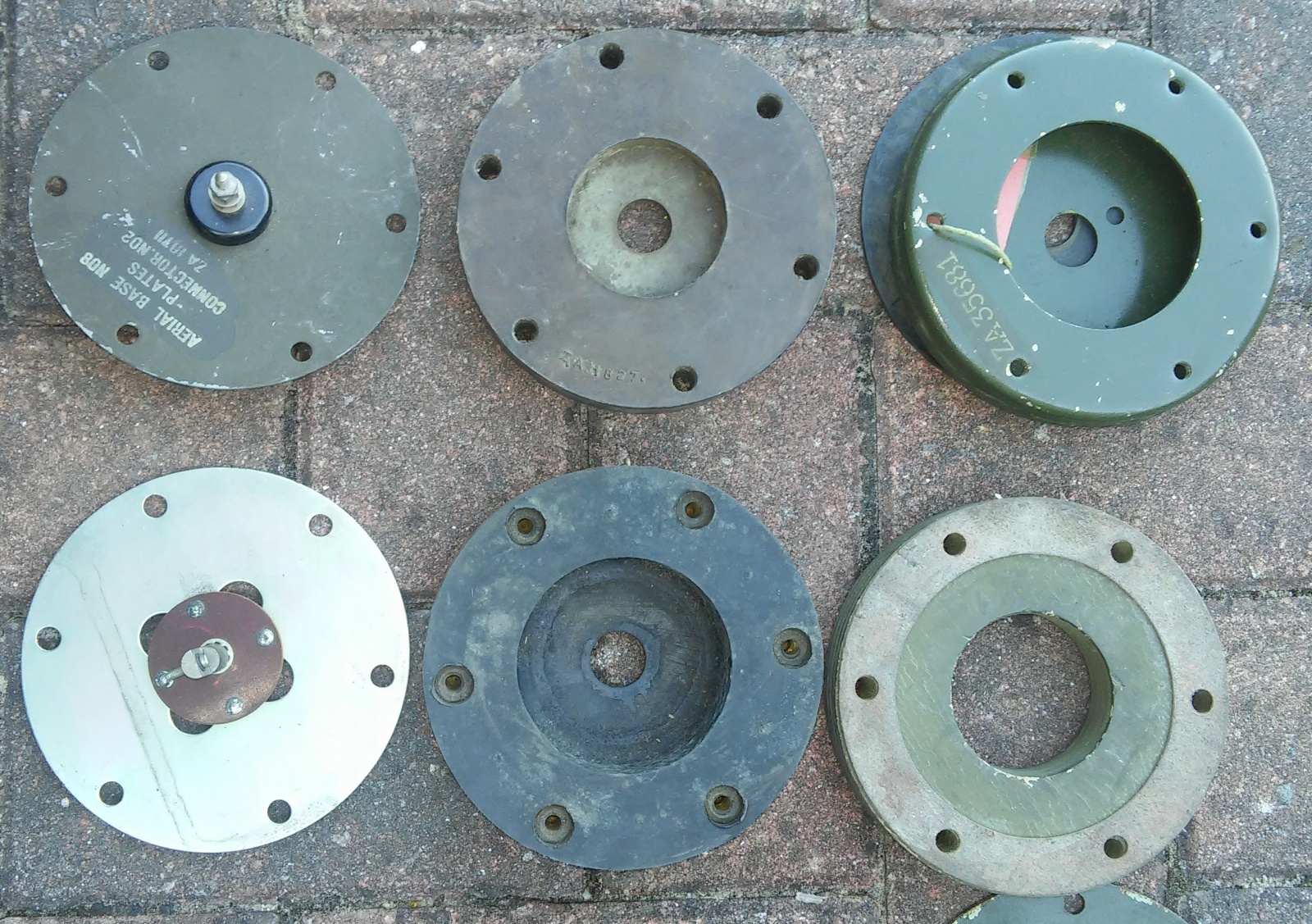

Can anyone advise please... what is the correct antenna insulator to be using with my Sherman Firefly installation?
This is my collection to date... hoping at least one of them is correct.
My guess is the item middle bottom - this has captured nuts within the insulator so the bolts screw into it. I am assuming it is held in place by the nut on the end of the threaded aerial feeder which attaches to the back end of the Variometer... is this correct? The underside of this part is flat, save for a small pin which would stop it rotating.

Of the two antenna feed plates... which of these is correct?

Hi Tim,
On the assumption that it's a 'through the turret roof' mounting, the middle of the bottom row is correct. I don't think you need a feeder plate, as the aerial pigtail should reach from inside the aerial base to the end of the aerial feeder plate/tube from the variometer. (The "Plates, Connector" are normally only for cable or co-ax fed aerial bases, or setups with an external junction box/aerial support like the Daimler Scout Car where you have a short jumper lead from the variometer feeder to the bottom of the plate and the pigtail to the top of the plate.)
If the turret is drilled for the American aerial base you'll need various adapter washers and other bits because the hole will be far too large!

Just looked up in the EMER book. There isn't a firefly specific listing. However under the listing for the Grizzly the insulator is
Mountings, Aerial Bases, No1, mk1 ZA1825 PC 76456 C
Everything else seems to use the
Mountings, Aerial Bases No3, Mk1 ZA1827 PC 76555 C

It looks like the turret comes pre-drilled for the U.S. aerial insulator, so you need various extra bits to fit the WS19 aerial base and variometer:
ZA.1825 Mountings, Aerial Base, No.1 (middle of bottom row).
ZA.2948 W.S. No.19, Plates, Packing (not sure what this is at the moment)
ZA.2957 W.S. No.19, Aerial Feeder No.4 (short tubular one for variometer)
ZA/USA 1051 Variometer Adapter Plate
ZA/USA 1053 Variometer Adapter Washer
This is out of a late-WW2 US Mk.2 install for M4 tank, so is probably what you need.
I think the 'Plates, Packing' is a large square washer that goes between the aerial feeder and the roof, and the "variometer adapter plate" is actually a bar with a pin and socket to transfer the locating stud on the variometer to a drilled socket in the roof, clear of the large American hole. The adapter washer is dropped in from the top and serves to centre the aerial feeder in the large hole (after which the Mounting fits over the feeder followed by the tabbed washer and the securing nut). (Do NOT overtighten the securing nut!)
It is possible that I have some/all of these bits. Finding them may be another matter.
No.1 has a steel plate with central hole and threaded bushes for the aerial base securing bolts. It's for a 'through the roof' feeder (Aerial Feeder No.4 or No.5) where the conduit of the feeder supports the variometer and is secured by a nut within the mounting.
No.3 is a plain disc which may be made of rubber, plywood, or steel (two cups seam-welded together) and has holes drilled straight through. It's a stand-off for use with the connector plate on a flat surface and requires nuts and bolts to fit it.
Later they were used together for the WS31AFV and WS88AFV to create enough room under the aerial base to terminate the aerial feeder correctly.
(This also required an additional fixture to simulate the 'conduit' of the WS19 variometer feeder.
Chris.

In the first thread picture, it is the top left plate (in green with the black isolator). I am sure that the bottom left (metal colour) would work as well.
