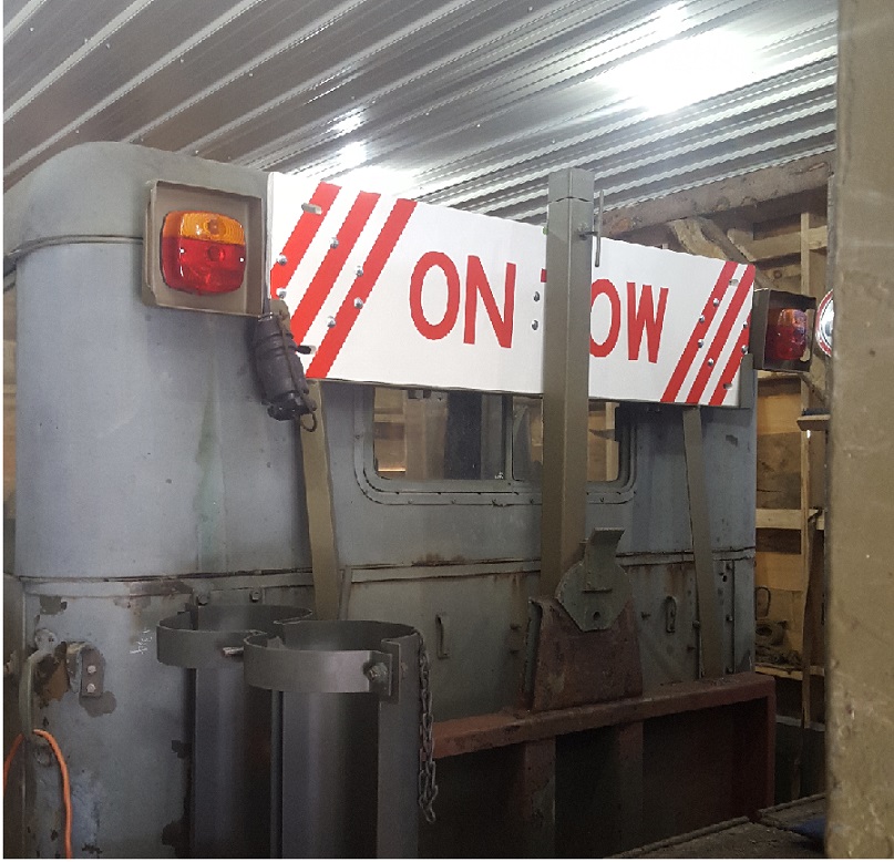

Here is the welding bottles relocation/resize and the trailer board stowage/telescoping beacon post ('T' piece and beacon bases yet to be fab'd) before I removed the hard cab. Soft top awaiting install, however minor hick-up to progress being rot to the compound sections in the cab under the door shuts.
I tried to add multiple pics but kept getting "failed" message.
Will try to get pics of modified rear steps, Holmes gear sub frame, TAC plate holders, Hollebone and spade stowage, transfer lever extension, external lockers, marker lamp guards etc., all things so far fabricated.
I have gotten some lamps from down under - though the cab side turn repeaters are so far illusive.
The paint on the trailer board, board support and the telescoping beacon post is the end colour that you sent me the official paint chip/card of.
Currently, I am doing all the mods and some protective painting as I go, but overall paint will be done later.

<<I am very vague on the 816 tail light arrangements.
I think the big M series stop light was used..........And may be direction indicator/tail light from a Australian International truck fitted as a extra light either side.>>
Yeah - I am trying to figure out the logic with the regs and the spare stop lamps.....

So glad that you know him - he's been a fantastic source of info for my build - and the stories he has too!!!
<<I think a Aussie fitment was also a amber clearance light near the mirrors and I think there was a amber direction indicator light ...........A long thin thing high up on the cabin somewhere too.>>
I do need to try and locate a pair of the long cab side direction indicators - though I am going to hate mounting them through the soft top!
The mirror ones appear to just be little round amber lamps.

Supplementary side direction indicator lamp
Hella p/n 2119 or P/n 2120.............should be the ones on the side of the cabin.
http://www.downunderah.com/page005.html
Hella P/n 2404 I think were used with the ON TOW sign.

I do not remember really well what was used on the rear besides the American M series lights.
Logic would suggest the Aussie army would use a rear light already in the parts system from a Australian ACCO 4x4 truck made by International Australia.
This link shows what the lens look like.
P/N....857716R91
http://www.aussieedsworldofoldtrucks.com.au/lenses
Extra stop lights don't matter in Australia.......but a amber direction indicator does and usually mounted closer to the side of the vehicle than the American M series lights.
Amber clearance light on mirrors or cabin roof common in Australia from the late 1950s
Ron

Hella rear Stop/turn I have already gotten from Phil - see Trailer board in post 3, though I need to get some torpedo 24v bulbs....
