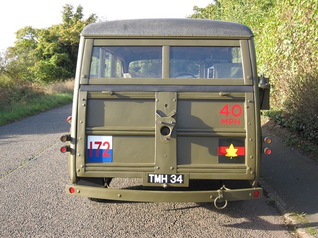

Cant speak for all models but certainly C11AS/CDF models had them fitted. Couple of CDF's clearly sporting them, dust and all!

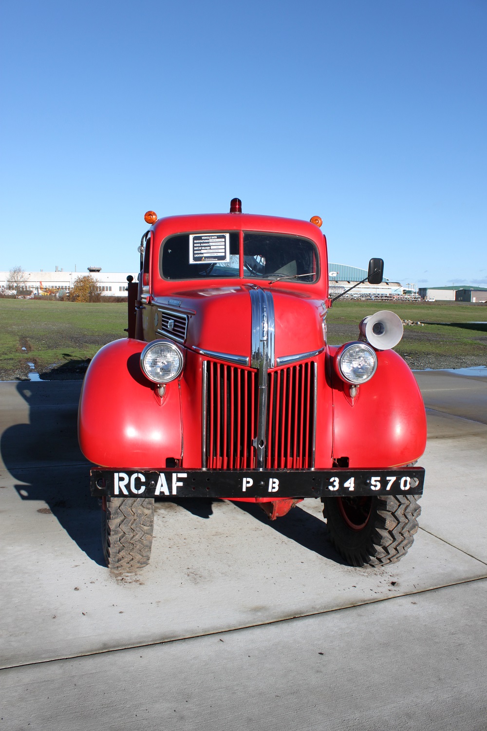

My 1941 Ford crash tender has all the holes for jewels on the ends. It is only 5" wide though, not 6" like my other CMP bumpers and the jewel reflectors I have.
