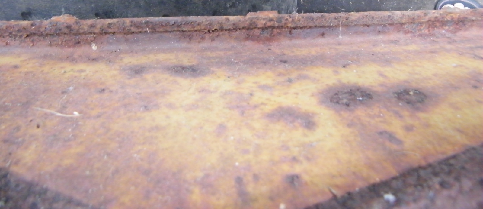

While waiting on sourcing tires, I decided to mock up some of the wireless setup by running the aerial cables. Removed the plugs through the armour and discovered that the aerial bases were bolted on, not welded on as I had assumed...
Here I thought that I would no longer have to deal with rust and broken bolts. Guess again. Onward.
Peter

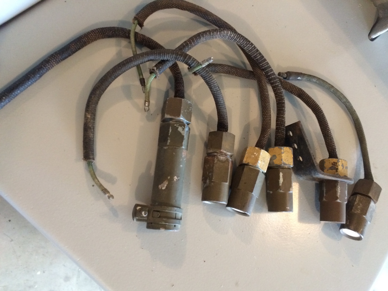

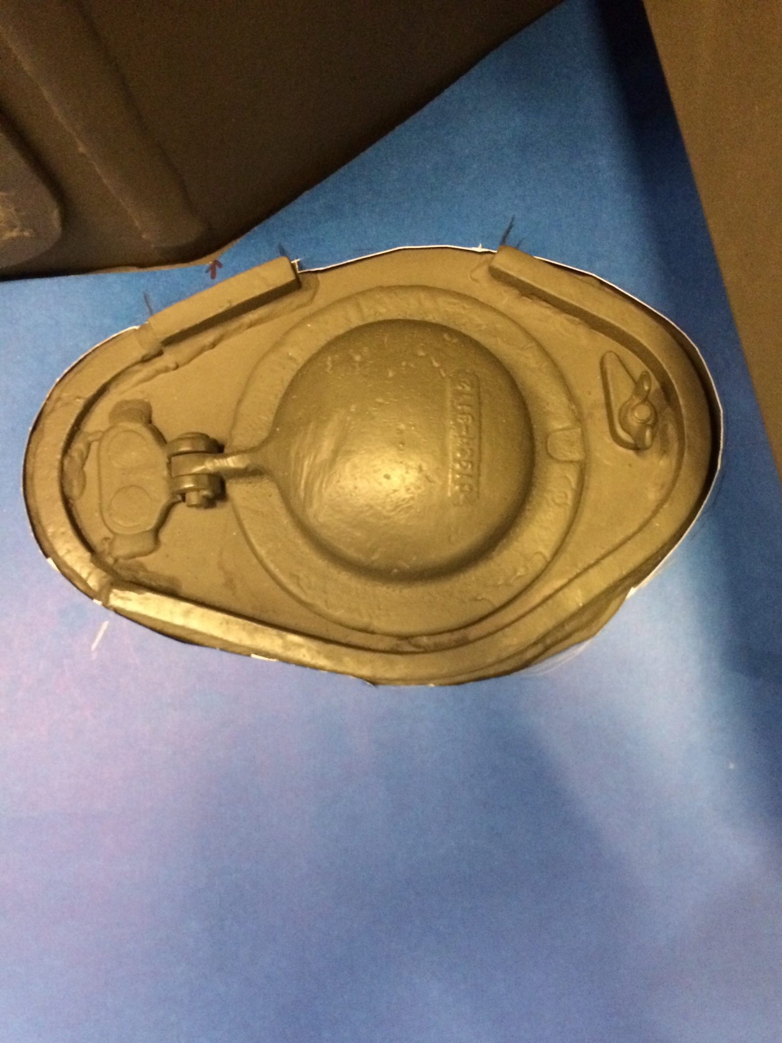

I'm trying to make my Lynx as original as possible, and I have had some very positive experiences with museums here in Canada.
I made a trip to the Canadian War Museum in Ottawa to firm up some details regarding the armoured cover over the fuel tank necks. Michael Miller was very supportive and allowed me to climb aboard their Lynx, take measurements, pictures and make a pattern for the splash shield.
I must note that these covers were cast from an original that came from the Royal Canadian Artillery Museum, in Shilo, Manitoba, and Rob Love was the individual that made this possible.
Without the support from these two individuals I doubt that it would be possible to faithfully replicate this set-up.
Now to challenge my young fabricator.

Hi Peter,
I thought it was probably common to both manufacturers of CDN built CMPs, but was only 100% sure of the Ford, hence my comment (I once owned a CDN built F15 cab 13 and an F60L cab 12). At least you can get the profile details easily now - you just need a local version of Colin Jones to whip a few lengths out for you in no time flat!
Lovely job you are doing on your Lynx.
  #570
Old 27-01-18, 07:08
Join Date: Aug 2012
Posts: 576
Default Stiffener
Just out of interest, the little stiffener dimensions are 1&1/2" wide x 5/8" high and 3/8" dia. internal pressing, Cheers Andrew.
Valentine MkV
