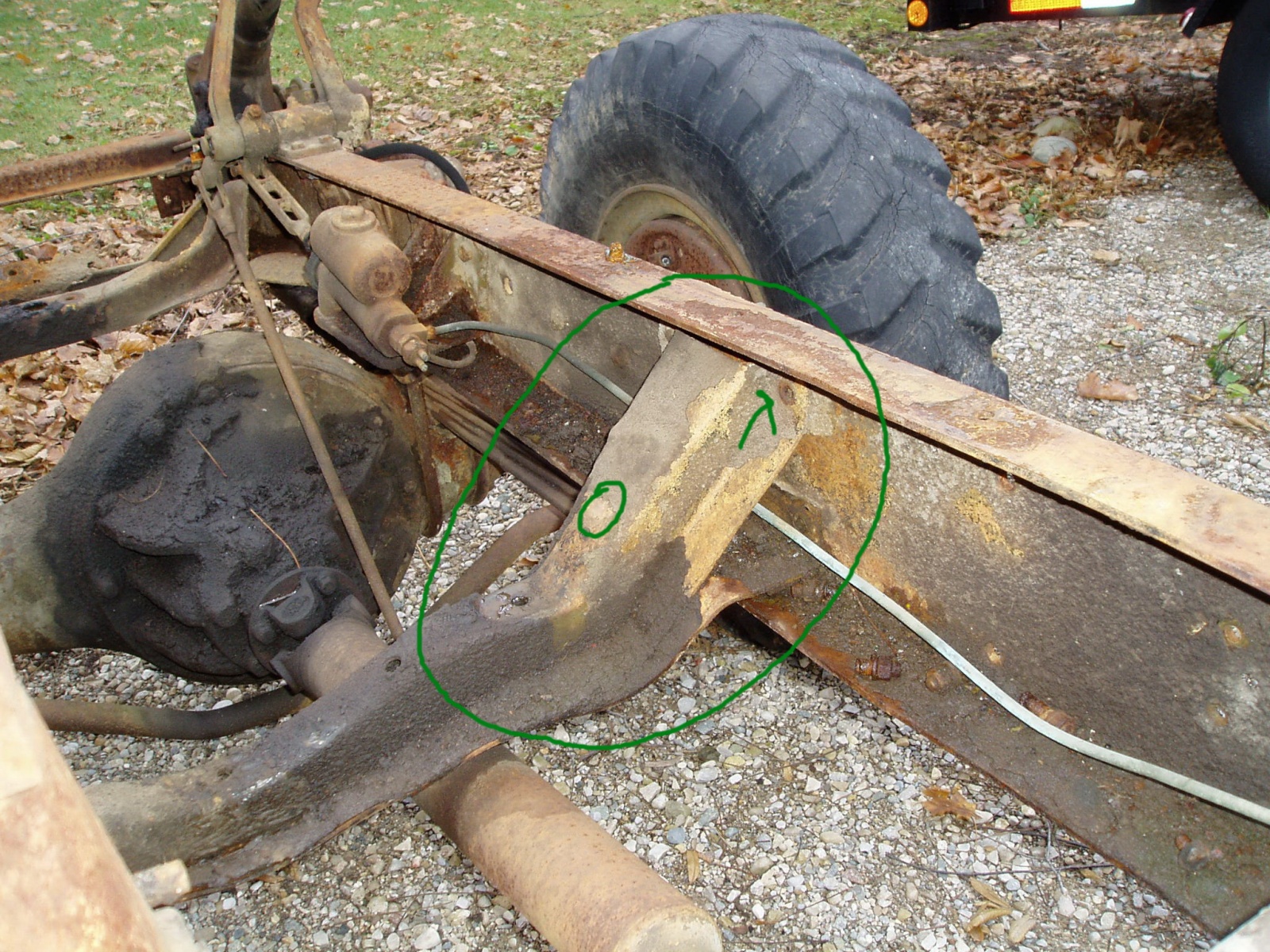

The frame that supports the rear section of the engine.... that allows the bellhousing side engine mount was also modified in production. Were that cross member bolts to the frame rail ....early models were prone to cracking at the upper rivets and sometimes early they reinforced the cross member with an additional layer of sheet metal....... subsequently carried on all cab 12 and 13. So Mike you might want to look under your C8 on each side where the cross member joins the frame rail...... feel for a rivet head holding the reinforcement.

Default Pictures for Mike
Here are two examples of the crossmembers.
Mike I would suspect that your early cab 11 C8 has the NON reinforced version.
RichCam..... you might want to check your truck to see if you have the early model and to make sure they are not broken.
