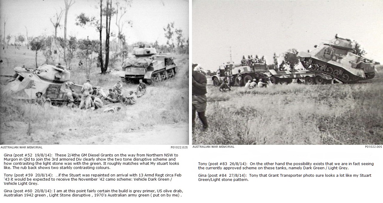

Perfect example of confirmation bias is Gina’s Stuart, which all the evidence indicates received Young’s “Vehicle Light Grey” treatment in the field, slapped on with 4” brush over existing “Stuart Green” using Young’s pattern charts: “a set of new designs were prepared, complying with disruptive and countershading principles of camouflage”. Gina has painstakingly reconstructed Young’s pattern chart for Tanks M3A1 Light, which I’m sure would have delighted Young himself, but he would have been aghast at the colours specified: Khaki Green / Light Stone. Unsurprisingly Gina has been unable to match the actual paintwork on the tank to any known colour.
Name:	second 4 on way to Murgon.jpg
Name:	Gina's Stuart disruptive pattern.jpg
LHQ's SM4809 has no provision for a two colour scheme, using a pattern that matched those issued in MC319. So, again, I think you are making too great a leap from local variations to the use of a two tone scheme of Dark Green/Grey applied in production
