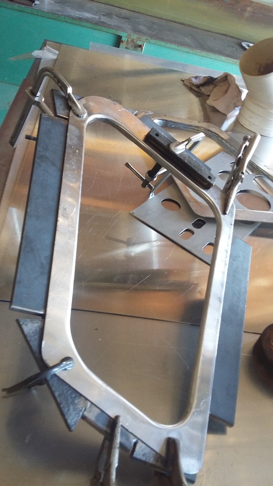

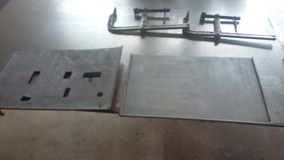

I am fortunate to have an original clutch, brake, Accelerator floor plate so I replicated one today and some more linkage. The plate has a 1/4' wire edge which I can do on my bead roller.

There are quite a few panels inside the tank that this machine will be very useful for. I cut the holes in it with my cnc plasma cutter.

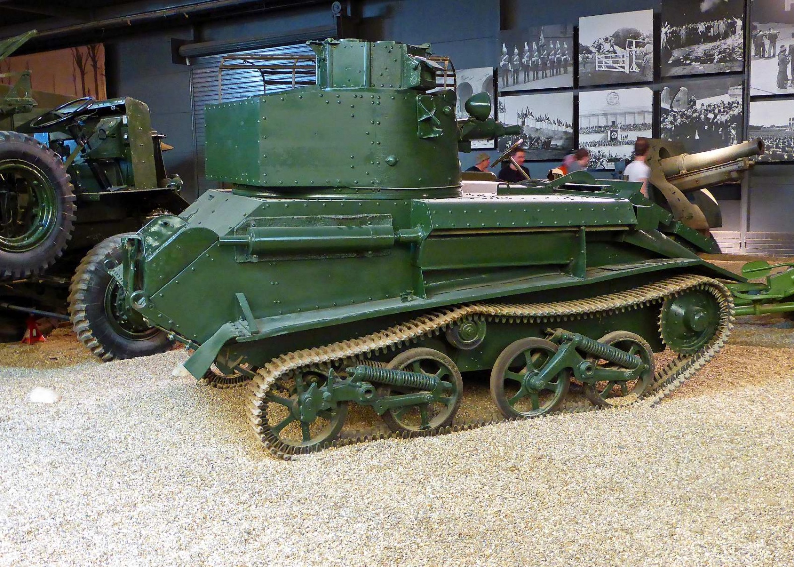

Three photos off the web of the Pucka Vickers and another two from somewhere else.
Regards Rick.

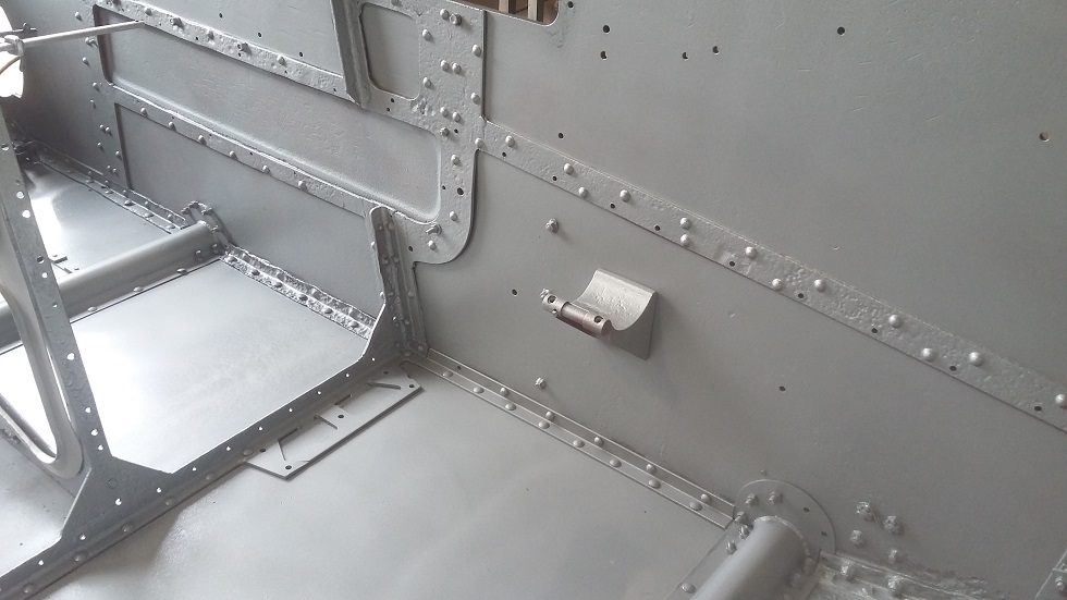

With all the photos of the Vickers I can't seem to find one of the bracket that is in the last photo here. Does any one know what it is for. It's not for a jack but it does look about the right size for a Vickers water jacket.
Colin,
It might be part of the bracket for holding the oil can, cannot make out the exact position in relation to the engine bay/rear crew section. I have some stowage diagrams that may help.....maybe not !!!
One of the drawings (not numbered) has a layout of some internal stowage on the hull sides, there does not seem to be a bracket listed as such, but there were all sorts of items stashed there. The drawing shows clips and fittings, hope this helps a bit ???

Colin, is that in the engine bay? Is it the generator mount?
Another from the web.
Regards Rick.

Lynn, no, the engine bay is in the front part. The generator is bolted directly to the engine. I'll get a better perspective photo tomorrow. It holds something about 4" in diameter and I have only seen one other tank with it in view as per the photo att.

Could it be for storing the 4" smoke launcher tube?

Hi Jordan, that too crossed my mind as I have never seen one in the flesh. They do have a detachable one that fits on the drivers side of the turret so you may very well be right. I'll get some close ups today.
The 4" discharger tubes were an outside thing. There wouldn't have been the need to take it off and store it inside so I doubt it's for that.

Well I don't think it is for smoke discharges as it is for about a 6" dia item. It is aluminium and it's fabricated. It is just above the floor level and it is not covered by any bulkhead panelling. It has those two threaded holes and I can't see anywhere for a strap to hold something down. It does not line up with anything on the engine and I cannot see where there is any wear marks
