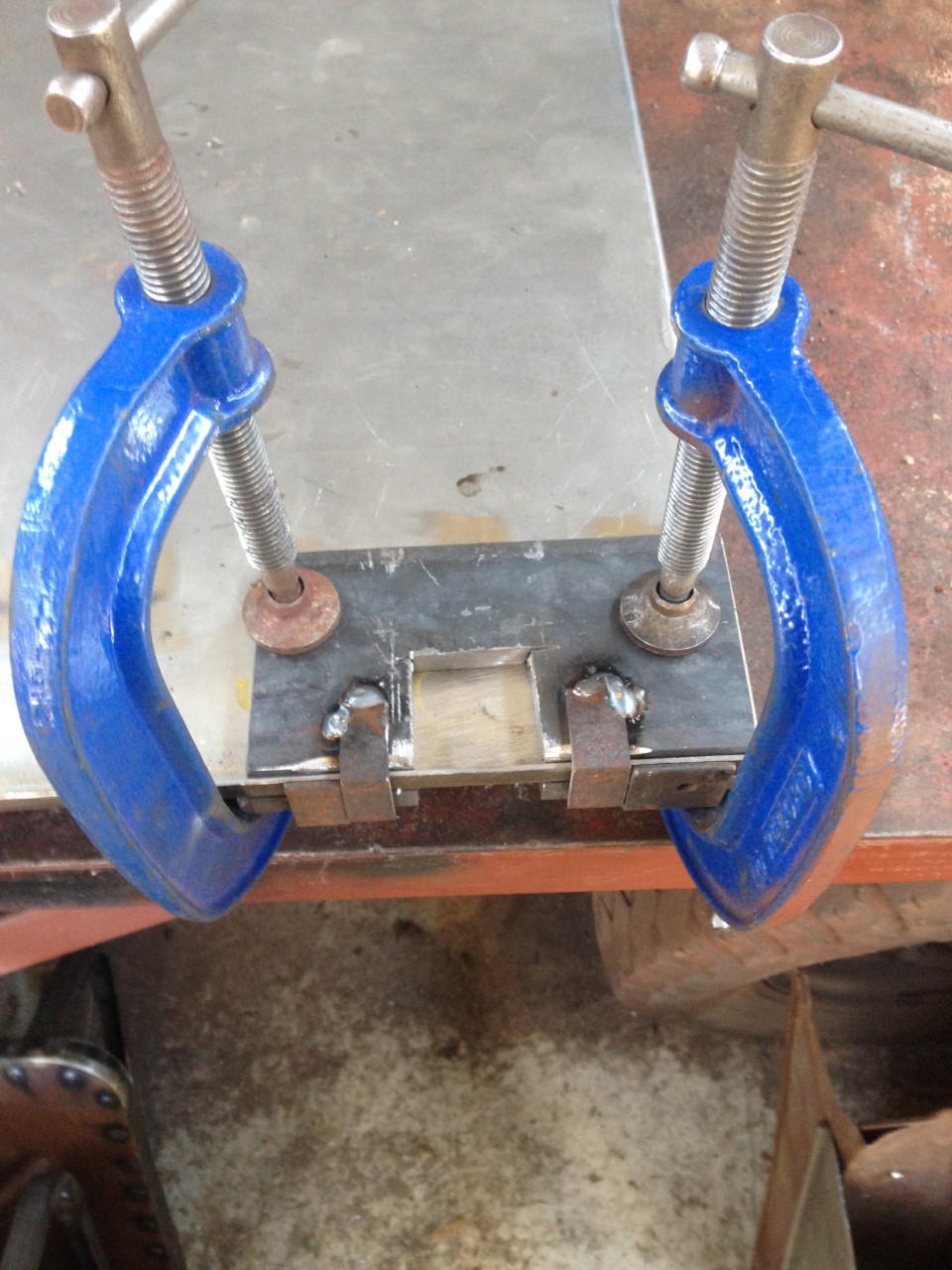

I had some sheet metal folded and scribed the shape onto it. I cut a piece of 10mm bar the same shape to dress the edge and folded a new piece of 4mm wire into the edge using a pair of pliers.
thumbnail_IMG_4195.jpg   thumbnail_IMG_4197.jpg   thumbnail_IMG_4198.jpg   thumbnail_IMG_4199.jpg

I cut a piece for the reinforcing and plug welded it in place

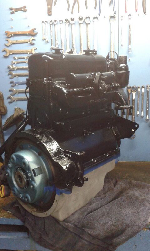

appologies for a lack of activity, There has been progress but its slowed somewhat. We had been waiting for a loom for some time, but eventually got it from a local supplier of Vintage looms. Engine and gearbox mounts were few and far between so we contacted Old Era services who fabricated new dies and refurbished our old mounts, and did an amazing job.
Mean while our friend and Morris Register of Victoria Techo Rod Smith, assessed our engine collection, three Tilly engines and two Morris 10 engines, and began work. on our first tilly we will use the SU carby as used on the morris 10 as we only have one Tilly carburettor (SOLEX 30 HBFDO). i do wonder if the Solex will be a weakness, as the SU has such a good name for reliability. No matter thats what they had, and I'd like to get a second one day, but there will be plenty of time for that.
sadly only one Original Tilly block was usable, so we've settled on using a car block modified to Tilly spec using bits ratted from the Tilly engines to build the second engine, sadly there aren't a lot of detailed photos other than a general impression of progress. See below.
20171228_141450.jpeg   20171228_143835.jpeg   20171228_150406.jpeg   20171228_150413.jpeg   20171228_150418.jpeg

A bit of additional grinding and a few more pieces welded to the block to prevent some distortion and the final result has produced something close to what we need.
