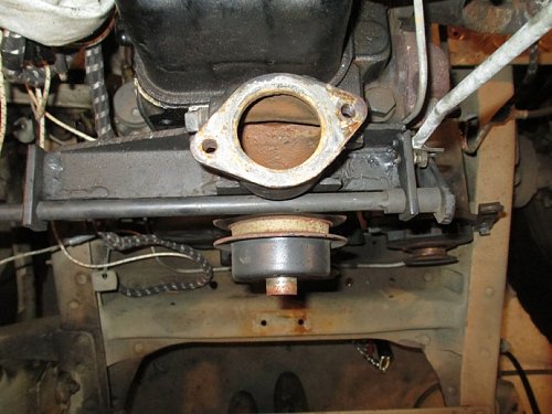

The few engines we have been working on in recent times were all single hole, narrow cross section (front to rear top) models per attachment 1. The 3 engine we have acquired in more recent times are all 2 hole water pump models with a wider front to rear cross section per image 2. This then causes a problem with the throttle linkage from the former model as there is insufficient room to mount same. Can anybody shed some light on the variations please. Have we got hold of a few car engines?? One of the latter came in the C60S tipper chassis. Regards.... Rod

Which Pattern are you working on? I've worked around the later design 2 port water pump on both and can take some photos of how it was done. Really not difficult, just some fabrication.

Phil thanks much for the quick response and yes please I would appreciate the images and any advice. Not being expert in the field of Chev. 6's this one caught us out temporarily. We have taken the test run engine (2 hole pump) from the tipper after a few repairs and it is now sitting in the No 6, Arty Tractor. It was not until we got to that stage that we realised that we had a linkage problem with the 2 hole water pump variant. From what you are saying am I correct in assuming that both 1 and 2 hole (water pump) 216 engines were used in Chev CMPs. Thanks again..... Regards.... Rod

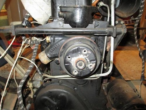

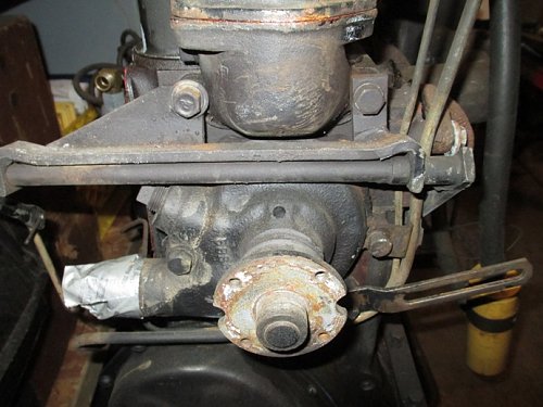

Tonight I pressed off the early one hole water pump flange and then put it on my two hole water pump shaft. This way I can fit the original larger wartime pulley on the two hole water pump fitting the engine I'm going to be using. However I find that doing this has made no room at all for fitting the throttle linkage. I've read that if I use the smaller pulley I will overspeed the water pump causing cavitation and or possible fan failure.
Any suggestions?
Or can I just put the smaller pulley that came with the two hole pump back on and use the 6 blade fan? But if I do that do I need to also change out the pulley on the generator?

It is important to note that the part that bolts in to the head, and accepts the Thermostat is special on CMP....... their is a very visible flat surface in the elbow directly above the fan pulley...... after war civvy parts DO NOT have the special indentation and you loose over 1/4 inch of much needed clearance.
I adapted a 1959 Chev 261 using the proverbial "adapter plate" and did have to modify the linkage that fits below the next and above the pulley. I will scrounge my pictures to find some illustration..... and similar to Phil I am referring to a cab 11...... and I have traded many cab parts between cab 11 and 12 and they all fit.

Thanks guys.
I'd ultimately like to use the one hole 216 water pump as it gives all the room that is needed. However as I posted in the other tread I'd need to do some serious surgery to the engine block and make up an adaptor plate.
Bob, I believe I've got the correct elbow with the flat spot.
I'm just confused by all the swaping around of pumps and pulleys.

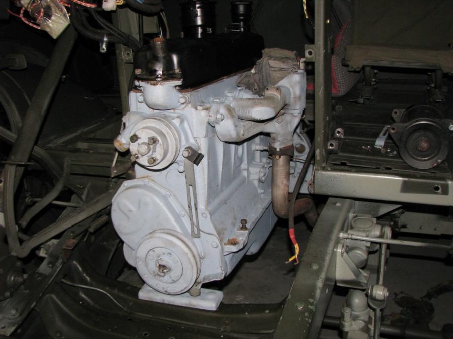

First just to clear up the cab 13 versus cab 11/12
The first picture shows a cab 13 set up..... the rod is shorter and is connected to another straight rod that goes to the gas pedal.
PS...... just noticed that the second and third picture show evidence that the throttle shaft was grinded above the pulley to gain clearance...... shinny area.
*****(The second set of grey engine set up shows a cab 11/12 longer arm set up.) **** WRONG it show same cab 13 set up.

Bob, in your last picture is the throttle rod ground down to provide clearance?

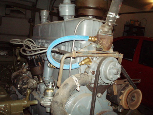

Default Now for pictures of my modified cab 11 linkage
First the original set up on my cab which was equipped with a GMC 228 engine BUT I have verified with other cab 11/12 and the set up was near original.
IM001721enlarrowstext.jpg   IM001724breatherarrowtexta.jpg   HPIM7320enlbbfinal.jpg

Has no modification and he made it fit ...... not sure how????

My understanding is that Grant used a 261 and a home made adaptor plate to fit an early one hole 216 water pump. Using the one hole pump there if enough room to fit the throttle rod unmodified.
My engine is a late 216 that used s two hole water pump, this means I have to either modify the throttle linkage to fit or find a way to fit the early one hole pump to a two hole pump engine. I'm not sure this is possible.
At this point I don't recall if it was careful parts selection or pure dumb luck but I think it was a close fit although I do remember it not having a lot of spare space. There are a variety of thermostat housing castings, each a bit different from the others WRT wall thickness, clearance angle at lower front and overall bulk. There are also slight manufacturing differences in the throttle linkage across the front of the engine that can help/hurt. And... there are several different casting numbers of each of the 1 and 2 hole pumps that vary slightly in shape (plus aftermarket pumps) to add or reduce clearance. I remain very nervous about the idea of modifying the 2 hole 216 block to accept a 1 hole pump. it just looks like more holes, closer together than I am comfortable with - but it might be alright in spite of my nervousness.
