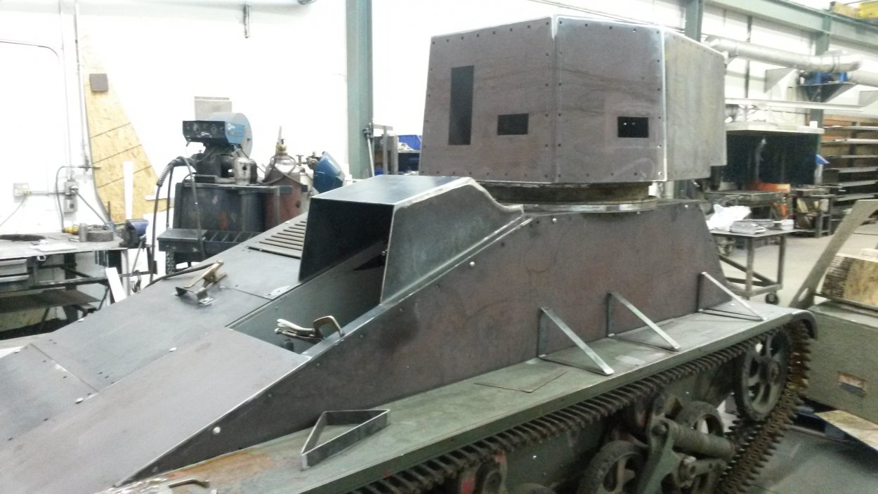

Well with spring break here it was nice weather for the first 2 days then snow and cold.... Typical Alberta. Vision ports and turret finishing bits is the plan for the next week. Here are some pics of the vision ports as I begin finishing them.
One for the drivers position and 4 for the turret. Having that big gaping hole covered over makes a world of difference to the look of this machine.

Default View ports done.
Well with the miserable minus 18 weather out here it took longer than I would have liked but the view ports are done and installed. They are spring loaded and have a 1/2in plate of acrylic (Plexiglas but harder) as an inside glass. They are all operated by a lever that passes through into the inside and work quite well.
I reattached the pic from the Dutchman tank at Bovington to give a comparison. They are not perfect but I think they will pass the look over test unless you have the other to compare too.
All that's left now is the barrel, ammo rack, front fenders, periscope, camo pattern paint and the data plate. Should be completed by summer and on it's way east.

Default a few more final pics
I an still waiting for the barrel to come back from the machine shop but other than that it is pretty close to done. I honestly sit out there and look at it and can't find more stuff to do. Paint touch-ups are getting tedious.
These pics are a few weeks old but I will have the finished product put into a video and I will post the link here once it is complete.
I have added a real periscope from a Russian vehicle (funny writing near the cross hairs gives it something extra) as well as ammo racks and ready racks in the turret. The final stenciling on the inside and the stamping of the numbers into the plaque are all that's left to do. I hope to have it out for a real trial run this month and have already scouted out a place with hills and woods to run it in. If all goes well I will take it to it's first show on July first. A second in August is almost a sure thing. Then it will become a barn queen as I move on to my next project.
To compare, here again is the in service pic from the Latvian army. I want to find a similar spot to do a identical shot to compare.
colour front with plaque.jpg   colour back right.jpg   Colour side shot.jpg   Latvian Vickers Number 204.jpg
