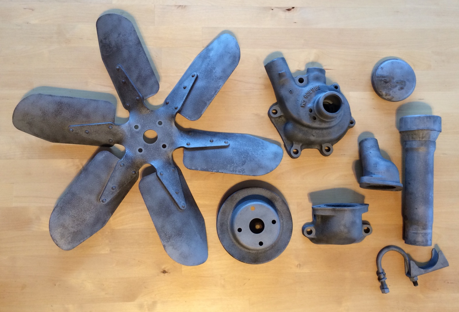

Finished painting the parts last week. I brought them inside for painting since it was pretty cold out in the shop. Only heard a few comments about a slight paint smell.

Hi Jordan
As I he had very good luck finding the fan with my fingers, in the dark cramped engine conpartments of CMPs I've taken to painting the first 2 inches front back of all fans either white or red.
Dam that smarts, been lucky nothing more than minor cuts and bruises but after it happened the second time got out the paint.
Just a thought

I've thought about painting the tips a different colour. I may still go back and do that.

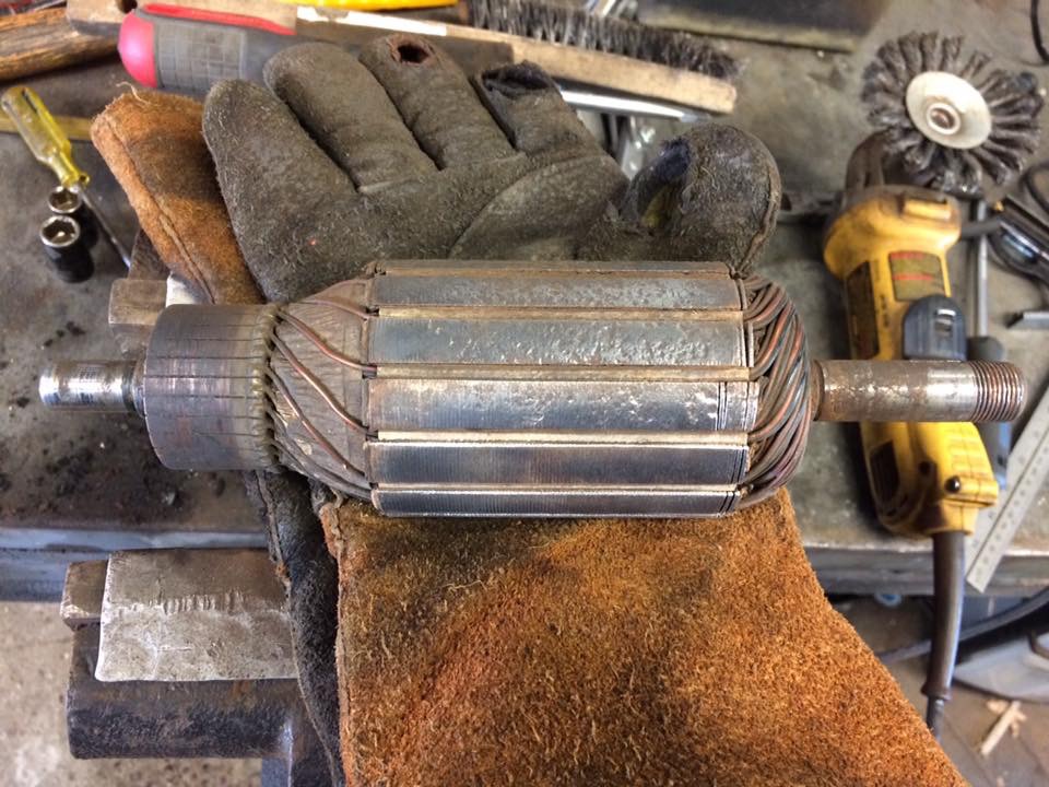

Nice work Jordan. Did you do anything to the armature? eg undercutting the mica?

No the armature was in great shape. Just polished it up a tad on a lathe.
