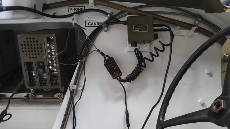

I am at the stage where I am fitting and wiring the BC606 interphone boxes and the wiring to the FT237 radio tray and I’m hoping to get some advice from the M8 gurus out there.
I have the TM 11-2702 manual for installation of the radio and interphone equipment. I also have all the other drawings and plans for the wiring of the interphone and radios, as per the photos.
What isn’t clear to me is how the BC606s for the commander and loader are connected.
The plans would suggest that the BC606s for the commander and loader each terminate at the terminal boxes in the sponsons, which I have fitted. It is not clear though how those two terminal boxes are connected. The BC606 for the commander is not the problem, as it has a direct connection to the FT237 through the terminal box in the sponson on that side. How does the BC606 for the loader connect to the commander's side though?
I’ve seen many photos of M8s (like the photo attached) that have the BC606 for the commander and loader connected by way of CO213 cable that is strung along the back wall of the interior of the hull. There is no indication of that method of connecting them in the manuals that I have found. I can see the ease in doing it that way, but is it correct?
I know there is conduit that runs along the side of the hull for each terminal box through into the engine bay. I figured this conduit just carried the 12 volt supply from the engine bay to each of the terminal boxes, for the power supply to radios on each sponson. Does that conduit also carry the CO213 cordage that connects these BC606s?
I don’t have the original conduit that goes through the channel from the engine bay along the side of the engine hull to the terminal boxes (as pictured). I also don’t have the conduit/pipe that runs behind the hull interior back wall in front of the fuel tank, so I am running a little blind on both fronts.
If you have any ideas, I’d be keen to hear them please.

I have now learnt (thanks to Willy) that the conduit that runs around the hull actually carries the 12 volt power supply for the terminal box on each sponson, as well as the CO213 cordage that links the BC606's for the commander and the loader. The conduit terminates at the terminal boxes and then there is a short length of cordage to each BC606. This fits with what I was seeing in the plans.
What I was confused about were photos of some restored M8’s that had the cordage on the firewall inside the hull connecting the commander’s and loaders BC606’s. I understand now that this is a post-war change. I’m going the wartime route with the conduit around the hull, providing I can get my hands on enough of the conduit!
I’ve now connected up the four BC606’s and the FT237 radio tray using the CO213 cordage. Preparing the cordage was a bit of a tedious job. Seperating the shield on the outside is time-consuming as it is very tightly wound around the internal wires.
I wired in the cordage for the driver and co-driver BC606’s in situ, only because I wanted to be sure of the lengths of the cable required. I wired the BC606’s for the commander and loader out of the vehicle and that was a darned sight easier. I’d have to say, that despite all the drawings and plans, without knowing exactly how it was all laid out, I still needed to do lots of research and have a good think about the layout and how it was connected both before and during the installation.
I was (and still am) a bit confused by the layout of the BC606’s. The plans show that the BC606’s for the driver, co-driver and commander should be positioned with the INT/RADIO switch and Volume Control side of the unit down. I setup the BC606’s for the driver and co-driver in this way as per the drawings.
I placed the loader’s BC606 as per the drawings with the INT/RADIO switch and Volume Control up. As I say, the drawings say that the Commander’s BC606 should be positioned with the INT/RADIO switch and Volume Control side down though, which didn’t make much sense to me.
What was the logic to how these BC606’s were fitted? I have seen numerous variations in the setups in restored M8’s, and a number of pictures of M8’s during wartime also showed variations. Why not keep them all in the same layout with the INT/RADIO switch and Volume Control upwards where the crewman can see it and change it if required?
In the end, I positioned the Commander’s unit with the INT/RADIO switch and Volume Control up, as per the Loader’s unit. I guess someone will correct me if it is wrong.

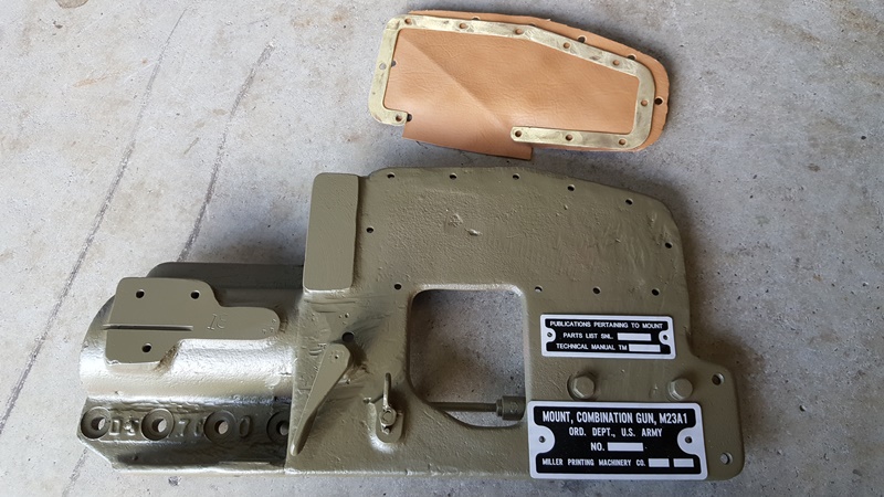

Along with the radio stuff, I’ve been trying to progress the gun. We haven’t been able to remove the two screws holding the recoil system in place. These screws have an allen type head on them but they were pretty knackered and corroded. I had been soaking the screws with penetrating oil for several months but the heads weren’t good enough to get a decent bite on them with the allen screw bit. We tried welding a bolt onto one screw but even then we couldn’t get the thing to budge. As a result, I will be taking it into a metal specialist next week to get the screws removed by spark erosion.
I got the boys in the engineering shop to profile cut a tool for removing the big nut on the barrel. This will allow me to remove the sleigh. Again, this nut is stuck and I’m better off having a tool that fits it properly before trying to lever it much more. l will give this tool a try next week and see if that will shift the nut.

All the radio wiring and conduit is in now, some albeit temporarily. I didn't have any pictures of this cabling before I started so these photos might be handy for anyone else doing this sort of restoration.
I haven’t connected the cordage to the BC606’s for the commander and loader yet. Once I have the radios and a battery in, I will check that the system is working with the BC606’s for the driver and co-driver before connecting the other two BC606’s. I don’t see any point in complicating things until I know I have wired it right.
The mounting of the conduit and piping holding the CO213 cordage is not finalised yet as you can see by the cable ties. You probably get the idea though. I could use some of the correct conduit clamps if anyone has any. My homemade ones just aren’t quite the right shape. I am still finalising the layout and there is a possibility I will have to move the cabling/conduit in the hull to get the firewall in, as that is a tight fit, and not something I am looking forward to fitting. I still have some routing of the wiring to tidy up but I think it is pretty close to how I want it.

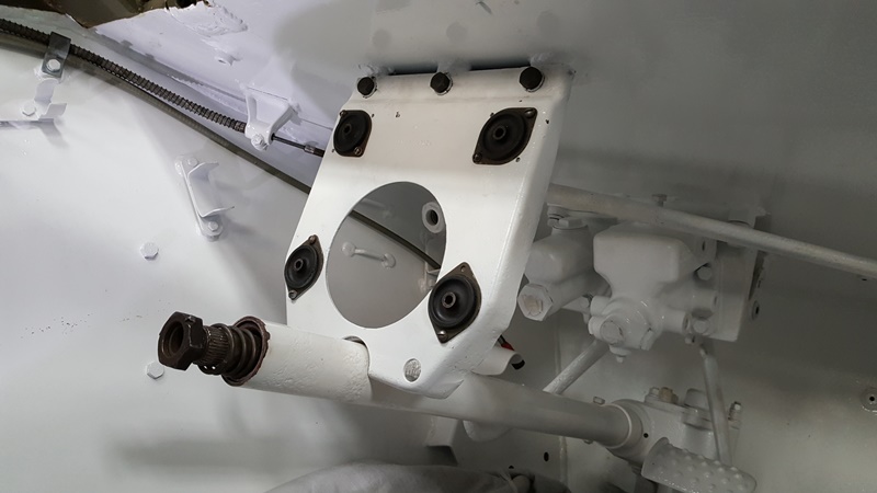

I fabricated a couple of pieces for the pushrods for the brake and clutch master cylinders, so I’ve now been able to mount the clutch and brake pedal assembly. The pushrod pieces aren’t my best work but they will do until if/when I source some new ones. I have some NOS return springs coming (thanks Philippe). I took some extra photos of the clutch and brake pedal assembly as I didn’t have a lot of photos of the layout. It is quite heavy and I had to use wooden blocks to hold this up while I bolted it in place. It is really a two man job to bolt it in but there isn’t room for two people in there!
The handbrake is now mounted. The mounting holes required 3/8” UNC bolts which had me fooled for a while. Most of the other stuff is UNF. The sector gear on the handbrake was pretty corroded and is not great but we’ll see how it goes.
I’ve fitted the steering box. I’ve used a grease and oil slurry in the steering box rather than just straight oil. The vehicle will be sitting around a lot and it might help prevent leaks. It has been sitting for a while now with no leaks so I have my fingers crossed.
I’ve done some touching up of the various mounting bolts in the front of the hull with the modeller’s paint but I still need to do a bit more.

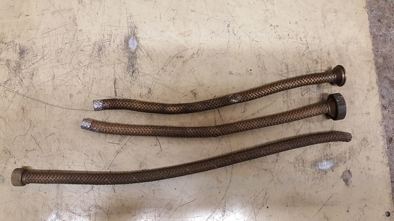

I need to join a couple of pieces of brass braided conduit. What method do you guys use for that? I’ve heard of copper sheet being used to join pieces. What about the brass fittings on the end of these bits of conduit? Are these ‘sweated on’ to the braided conduit?

I’ve found that the conduit for the siren has to be in a very tight curl to get it to fit, so I will need to experiment further with that.

Over the last couple of weeks I’ve been finishing a few jobs off and tidying up a few things up that I wasn’t happy with. I managed to get the M8 shifted around in the workshop. This gives me much more space around it to work on and will make life easier getting the axles in place.
The radios are in, pending me doing a test on the interphones to see if it all works. I’m charging up a battery now for the test. Fingers crossed it works. I’ve tidied up the instrument panel wiring and it is sitting in place, also pending testing. Hopefully all is connected correctly there as well!
I’ve started reassembling the front axle, starting with making up and fitting some new hydraulic lines. I had to fabricate the small mounts that hold the flexible brake lines where they connect to the fixed brake lines as I couldn’t find any of those. I have some nuts coming that secure the flexible lines to these small mounts.
The rubber boots on the axles were damned hard to get on. A real tight fit, but I got them on. I have the axle shafts in but I forgot to take the grease (!) to the workshop so I’ll do the axle shafts and joints tomorrow as well as fitting the sleeves and bushes that secure the steering knuckles to the axle.
One thing I have noticed that I don’t have is the nut which secures the Pitman arm lever to the steering box. This is a bit of an oddball size of 1 1/8”- 16 UNF and I don’t have one. Does anyone have one lying around in their box of bits and pieces?
I’ve just started on the hydraulic lines for the brake and clutch master cylinders. This is going to take some time with me not having any original lines to work off.
That's it for now...

Here is the last bit of work I’ll be doing before I skip over to France for a couple of weeks. I’ll be hitting the military fairs in Normandy so fingers crossed I pick up some of those hard to find parts.
The front axle is now complete, minus the nuts for the brake lines, which are coming. Brakes shoes, slaves cylinders, lines etc are all fitted. As I said last time, those rubber axle boots were dogs to put on. I thought the inner part of the boot was hard to put on, but the outer part was even worse. The boots I used were NOS halftrack ones and they were very stiff. I had to remove one that I had already half fitted and clamp it in a vice with some bits of wood and heat it up with a heat gun to stretch it. That got it on. I left the other side on and heated that up with a heat gun as well. I was then able to stretch the rubber enough on that to get the outer part of the boot on the steering knuckle. I’m told (thanks to Willy) that the best boots to use are the ones for the REO trucks. I don’t think it will be an easy job to ever replace these in situ, but if I ever have to I’ll be using the REO ones.
You’ll see that one of the slave cylinders is marked with a nylon tie The guy who put the stainless steel sleeves in the cylinders said that this cylinder has a split in the body. It shouldn’t affect the operation with it being sleeved, but I will keep an eye on that. The axle is sitting on a dolly now and I’ll slide it under the hull and fit it all when I get back.
I hooked up a 12 volt battery to the wiring to test the driver and co-driver interphones. The BC-604 transmitter and BC-603 receiver both started up as expected, but I noticed that the dynamotor on the transmitter was running all the time. I tried the driver and co-driver interphones with T-30 microphones, SW-141 chest rigs and HS-30 headphones fitted and neither worked. Bugger...I then plugged a T-17 microphone into the transmitter and that gave me audio at the two interphone stations. Okay, some progress, I thought….
I went back to the wiring diagrams I had. As you can see there are three slightly different versions of the wiring for the BC-606’s on these diagrams. I was just about to try rewiring them to one of the other versions when I noted the jumper on pins 6 and 10 on the connector on the FT-237. Two of the diagrams had the jumper on the FT-237, with corresponding differences at the BC-606’s. The diagram I had used though was the one out of TM 11-2702 and this did not have the jumper. I removed the jumper off the FT-237 terminal and straight away, I could transmit from the T-30 microphone on the co-driver side and hear it on the driver side. I noticed to that the dynamotor on the BC-604 was only running when the microphone was keyed which is correct. I tried transmitting from the driver’s side next but couldn’t hear audio at the co-driver’s side, so I obviously still have something amiss there. Whether it is a fault with the headphones I tried, or something internal in the BC-606, I’m not sure. I was out of time then so when I get back to the workshop I’ll work on that some more.
The T-30 microphone, by the way, seems to work really good. Much better than the T-17 microphone I thought.

The issue with your wireless gear does not surprise me. A chum of mine (retired commercial radio engineer) currently volunteers at the local RCAF Museum, restoring their wireless equipment. This past Winter he was having a heck of a time getting a late war American piece of kit to behave properly, inspite of several triple checks of the service manuals and circuit diagrams he had available. One circuit in particular was giving him grief and seemed odd to him, even though it was in agreement with his available information.
He was lamenting to me about it one afternoon over a coffee, wishing he had an earlier version of the manual to refer to. When he mentioned the manual reference he was looking for, it rang a bell and it turned up in one of my odds and sods drawers. When I dropped it off for him a couple of days later, it confirmed his suspicions. The later version he was working with had an error in the drafting of the circuit diagram that had been missed. He restored the circuit to the original diagram and the set popped back to life perfectly.
Makes one wonder just how many such errors are out there waiting to make our lives challenging!
