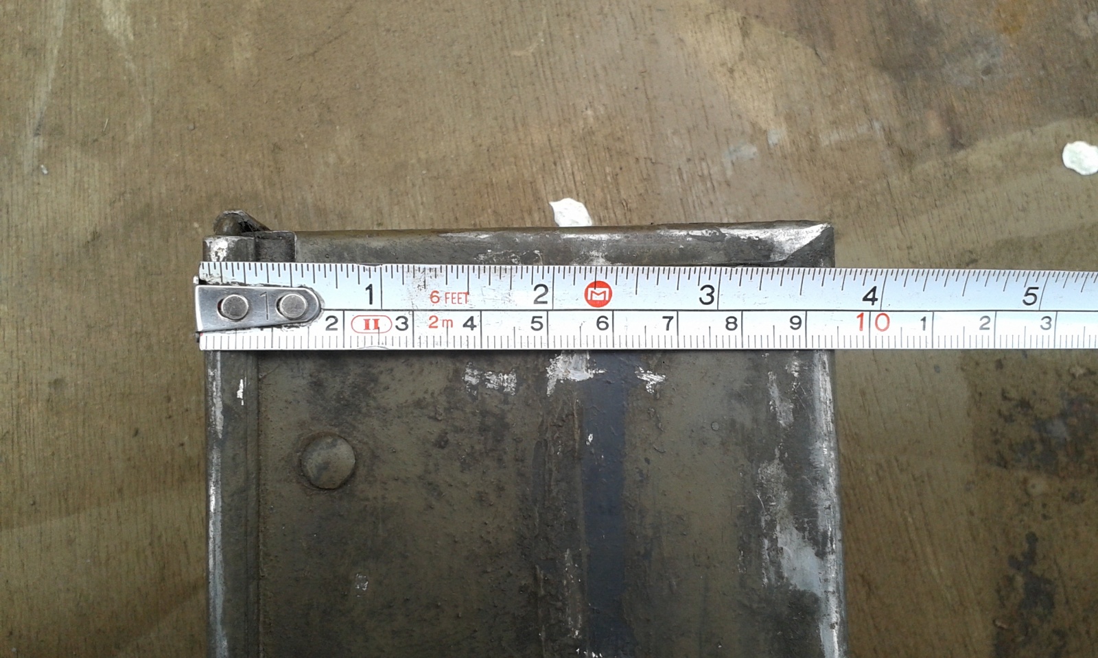

Hello Guy. Can you advise the dimensions of the un-identified box (tin) please.
Does it have any numbers on it?
Hey Lynn,
Unfortunately we did not find any numbers, I took pictures with the dimensions. It is presses the same box that I found on another link to MLU forum where you can see such a similar tray.
http://www.mapleleafup.net/forums/sh...ad.php?t=20221
With best regards
Guy
20180412_152651.jpg   20180412_152714.jpg   20180412_152725.jpg   20180412_152733.jpg   20180412_152742.jpg

Originally Posted by Guy Verstrepen View Post
thanks guys
thanks to you, I have come a step further.
in the meantime I am talking to a factory that can process all kinds of metal or it is possible to copy the water filters.
I will keep you informed here, but first I have to calculate some sizes because I have no real idea of the dimensions of such a filter.
greetings Guy.
Check out the attached image of the type 2 metafilter. You should be able to work out the size from the dimensions indicated.
Owen.
1940 11 Cab C15
1939 DKW KS200
1951 Willys M38
1936 Opel Olympia
MVPA # 39159
MVT # 19406
Old 17-04-18, 20:44
Guy Verstrepen Guy Verstrepen is offline
Join Date: Jan 2018
Location: Duffel, Belgium
Posts: 67
Thank you very much Owen.
It's going to save me many hours of work.
greetings Guy
