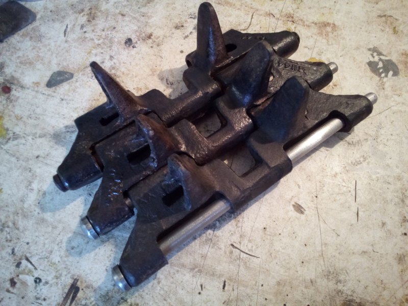

Just finished a couple of spare track pins. Could be useful in spare parts bin
UCw Mk.III

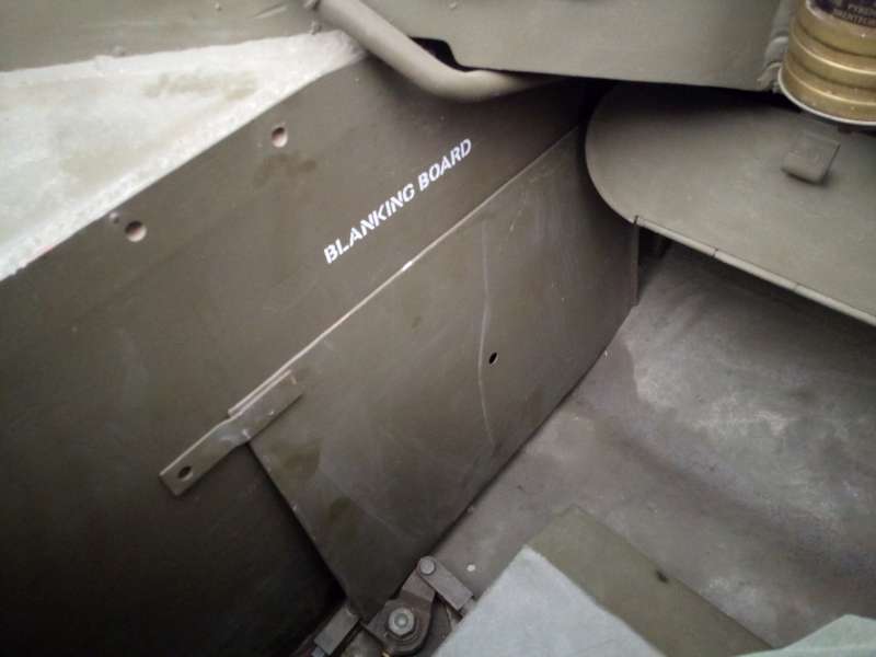

Some of you propably remember that there was one "mystery" part in batch of parts from my Mk.III which no one could recognize.
Now I can say this mystery has been solved! I was thinking about the center hole and its purpose and got some idea. Today I proved it by test. Part TL14588 (which I couldnt find even in Chilwell) is new style of blanking board which we are used to see made from plywood. This last evolution is made from steel and apparently used on last types of UCs.
Happy to solve it

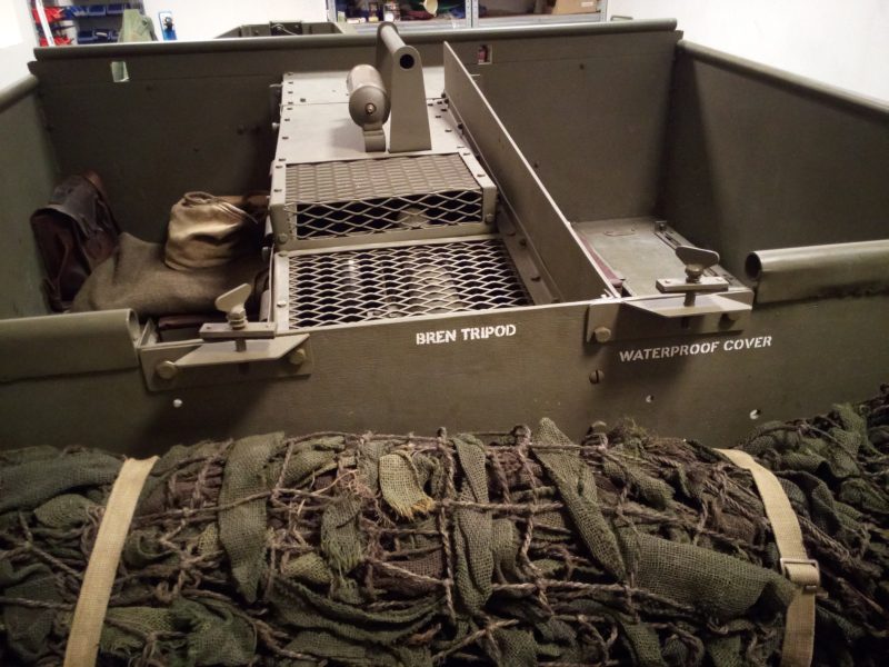

Few new parts in the production
UCw Mk.III
  #352
Old 22-10-18, 12:40
Join Date: Mar 2014
Location: Czech Republic
Posts: 549
And some are finished
