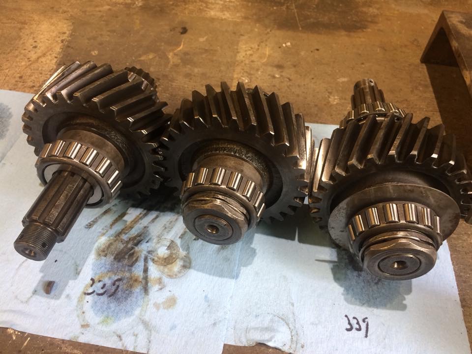

Old 29-06-18, 00:52
Posts: 4,184
Transfer case gears are all done. Well almost, just waiting for a speedometer drive worm gear to arrive from Holland. The original one chipped the threads while being removed. All new bearings, everything taken apart and cleaned up. Bearings were all dipped in oil before assembly. I’m currently just working on installing the new bearing races back into the case and cover. I also assembled the declutch shaft and carrier.
3101F79F-D46A-48FE-AD61-F978936225A8.jpeg   082FA4B2-7045-4425-95C0-EC600C2B6006.jpeg   E045B41D-F5B5-497D-8665-43F906D98918.jpeg   44C375B7-6AD9-475D-8008-88DB2A3282F8.jpeg
  #436
Old 29-06-18, 01:12
Posts: 5,259
Default Amazing size of gears.....
When you consider the limited 85 BHP..... of all the T case I have opened the gears are always in good shape.
Another alternative to dipping the bearings is to inject some molyb. grease with the needle of the grease gun into the bearing cage.....then spin by hand to coat evenly...... messy but it works and at least they do not start dry.
Good job Junior!!!!

Old 29-06-18, 03:17
Jordan, that speedo drive worm gear (as someone has already said) will be fine to use. There will be no tooth load where the damage is. It would be good to dress the edges where the damage is.
  #438
Old 29-06-18, 04:57
Posts: 4,184
I’m playing it safe and have a new speedometer worm gear on the way. I was thinking the chips shouldn’t be an issue, however when I lined up the other gear the teeth do pass over the one chip. Considering everything is opened up right now it’s easier to replace with NOS now versus down the road.
  #439
Old 29-06-18, 06:05
Posts: 7,619
Good on you for waiting, but I would concur with the others. The actual load on that pair of gears is so minimal, they usually make them out of plastic these days.
