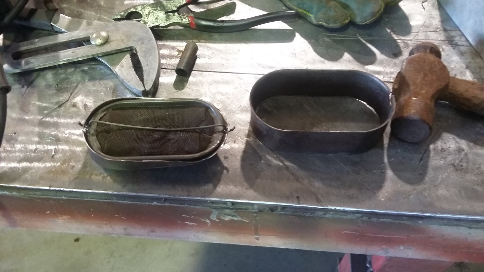

After looking at the comments it seemed a long process to find replacement parts which could take weeks and being the impatient person I am I thought it can't be that hard to change it, so I took off the spring wire and mesh guard and found the pick up tube was just hanging inside about 50mm. After checking the cross tube cover I decided to cut the shroud and the pipe which gave me the extra clearance I needed but only just. I took about 50mm off the sump and was able to graft it back on the same place.
I increased the depth of the front section which now gives me another 15-20%
more volume of oil. My sump plug is still in the same place which also lines up with the cover plate in the floor. So thank you for the suggestions. I should have not jumped the gun so quick
20180702_100338.jpg   20180702_100348.jpg   20180702_102712.jpg   20180702_103052.jpg   20180702_121155.jpg

The pick up assembly is purely a device designed to give the pump a pool of oil to draw from. The critical part of designing the intake to the pump is that there is oil there under all possible circumstances. In a tank this is more critical when the vehicle is going uphill as the engine will usually be at full throttle then whereas downhill it will usually be coasting so much less bearing load. Side slopes are a mid condition and flat usually easy to provide for. As I said before I think it is very important that you increase the oil capacity as much as is practical to prevent the oil overheating. It is not an option to use a car sump even if it was shallow enough to fit over the cross tube as you will boil the oil if you ever do any more than just potter about. Also loading onto a truck will let the pickup run dry as cars are not designed to be on that kind of slope. Remember that these tanks pitch badly both forwards and backwards in addition to the gradient.
Most relatively modern engines have the pipe from the pump going straight to the lowest point of the sump with a simple wire mesh strainer on the end and a tin shroud over that so that there only needs to be about 1/2" of oil to cover the intake. The CMP pickup is just a rather complicated version of that. Also modern oils have additives to reduce the foaming that wartime oils did not have. The CMP pickup would have been intended to try to separate air from the oil but that function is just not required any more.
You can have the pipe to the pump at any angle but the shorter it is the better. It is critical that it does not vibrate as it will vey quickly fall off ! It is also necessary that there is some sort of mesh to stop lose bits of rubbish being sucked in. Other than that it is just a matter of arranging things so that there is as much chance as possible of there being oil covering the end of the suction pipe. Sheet metal baffles that reduce the movement of the oil away from the pickup on slopes but still collect it from above can usually be designed and can be welded to the inside of the sump or fixed to the pickup as in what you have.
Not rocket science but just need some thought. Have fun !
PS: Colin posts much faster than me so I had not seen his solution when I wrote the above. I would put a horizontal baffle in the sump at the same hight as the new section and carrying on the line of the new section to almost the pickup. This would trap oil below it on uphill slopes but allow it to drain into the lower part of the sump on the flat. As it is you only have the capacity of the pickup assembly available when you are on an uphill slope and the oil has gone to the other end of the sump. The problem is that having reversed the engine the pickup is at the wrong end of the sump though I do agree that having the drain over the access hole in the floor is a good thing so the deep end of the sump needs to be where it is.

Hi David, sorry I posted so quick but I didn't think I would have sorted my problem so soon. Just to confirm though, the sump is still in the exact same rotation and configuration. What I have done is shorten the depth of the deep end and increase the depth on the low end which gave me more volume of oil in total by probably a litre. I do have the original oil cooler to connect to as well. The pick up was shortened by about 50mm. This should have fixed the problem and I will find out today when I do another trial fit.
Thankyou everyone for your help.

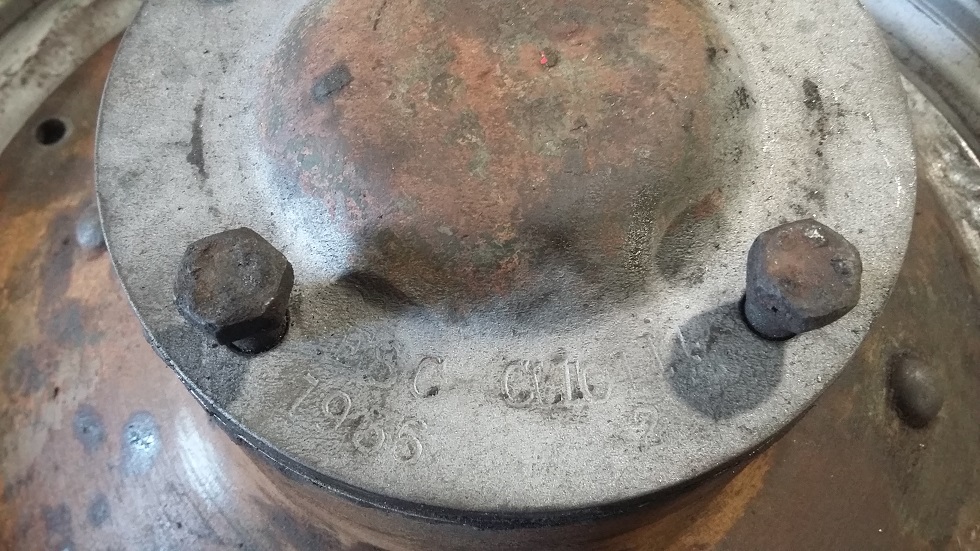

Having only one drive hub I am attempting to fabricate another. As far as I know, the missing one is on the Vickers at Duxford. Anyway! I cut some supports so it retains the flat surface while bending. I know I won't get the exact shape but somewhere acceptable. I drilled through all three sections to stop it from pulling in when under pressure.
20180708_154859.jpg   20180709_072449.jpg   20180709_080547.jpg   20180709_082416.jpg   20180709_082443.jpg

I am going to fabricate the bearing housings, weld and machine the excess off after completion. I need two more for the other tank but will wait until I decide what type of drive system will be suitable. after I weld in the boss, I will be able to lathe the outside perimeter down to size. The holes that are in the dish at the moment will be machined off and new holes put in the correct locations.
20180709_082812.jpg   20180709_084936.jpg   20180709_101033.jpg   20180709_102409.jpg

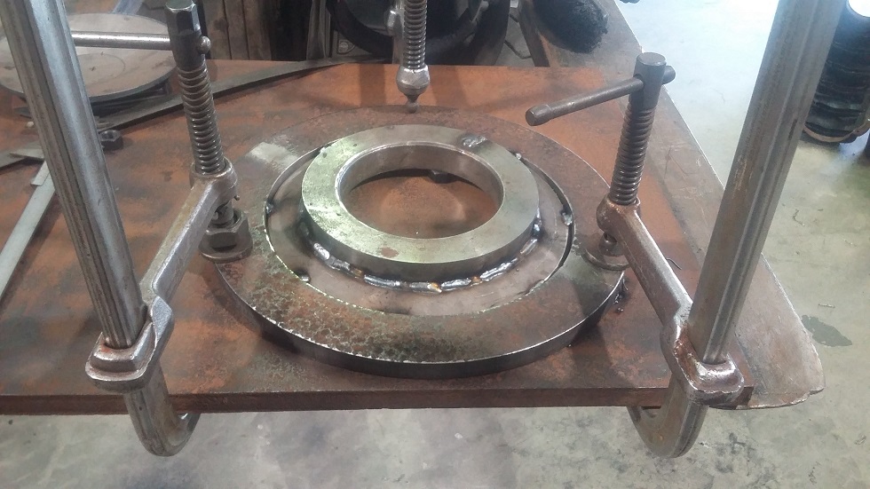

Almost finished the drive hub. I just need to drill the perimeter holes, face off the plate edge and make the bearing spacer that fits in between the two bearings but I will wait until I get my new ones. I sure will be disappointed if this tank doesn't drive after all this work But I do have plenty of confidence she'll work.
20180710_091558.jpg   20180711_113948.jpg   20180711_114002.jpg   20180711_114133.jpg   20180711_114140.jpg

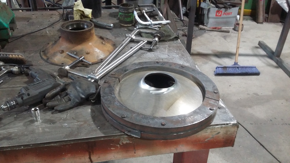

This part is the reduction hub off the drivers side and I need to make a complete one for the other side. The other part I just made was the outer hub which brings me to a question.??
I remember seeing on a thread some where here a T16 diff in pieces for refurbishment and I'm pretty sure I saw a similar set up. Am I right saying the T16 diff is the same. The chances of the gears being the same would be remote but has some one got any photos or info.
20180711_170443.jpg   20180711_170510.jpg   20180711_170517.jpg   20180711_170623.jpg   20180711_170719.jpg

This part is what holds the reduction gears and hub. It's probably the most intricate part to fabricate. I'm using what ever steel I have lying around the place and I don't mind welding pieces together.
20180714_084142.jpg   20180714_084154.jpg   20180714_084234.jpg   20180714_084306.jpg   20180714_124137.jpg

As I don't have a supply of heavy plate steel in the widths I need, you can see I have welded sections together to suit my purpose. I am happy that my joins are satisfactory.
20180719_133925.jpg   20180719_140514.jpg   20180719_151424.jpg   20180719_161709.jpg   20180719_162535.jpg
