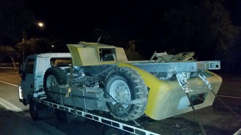

Background info - My pop passed away last 2 years ago at the ripe old age of 96, and he was a veteran of WW2 at Milne Bay in the 2/5 Field Coy. I remember all the long stories he told me about his time during the war and really enjoyed listening to him and I can assure you he enjoyed telling them. I remember him telling me about the vehicles that he drove and one in particular - the Blitz Wagon. Years prior, I took him to Canberra to the Australian War Memorial and walked around for hours, he could talk about almost everything that was there and especially remember looking at the Ford and Chev Blitz wagons that were on display.
After he passed, some money was allocated to all his grand children and I really wanted to do something to remember him but also something that I do enjoy.
So, having seen Blitzes on some trading sites for sale I really wanted to restore one but also with the intention of being a daily driver - yes, a daily driver.
Here is the vehicle the night that I picked it up:

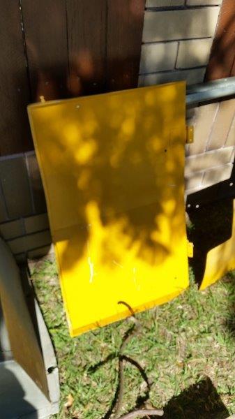

The cab, painted in caterpillar yellow.
20170911_205335sml.jpg   20170911_205423.jpg   20170911_205437.jpg   20170911_205355.jpg   20170911_205448.jpg

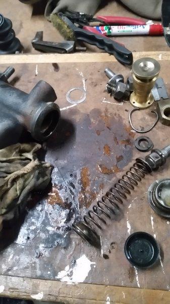

Rebuilding the brake cylinders
20171030_200837.jpg   20171030_200840.jpg   20171030_200845.jpg   20171030_200851.jpg   20171030_200857.jpg
