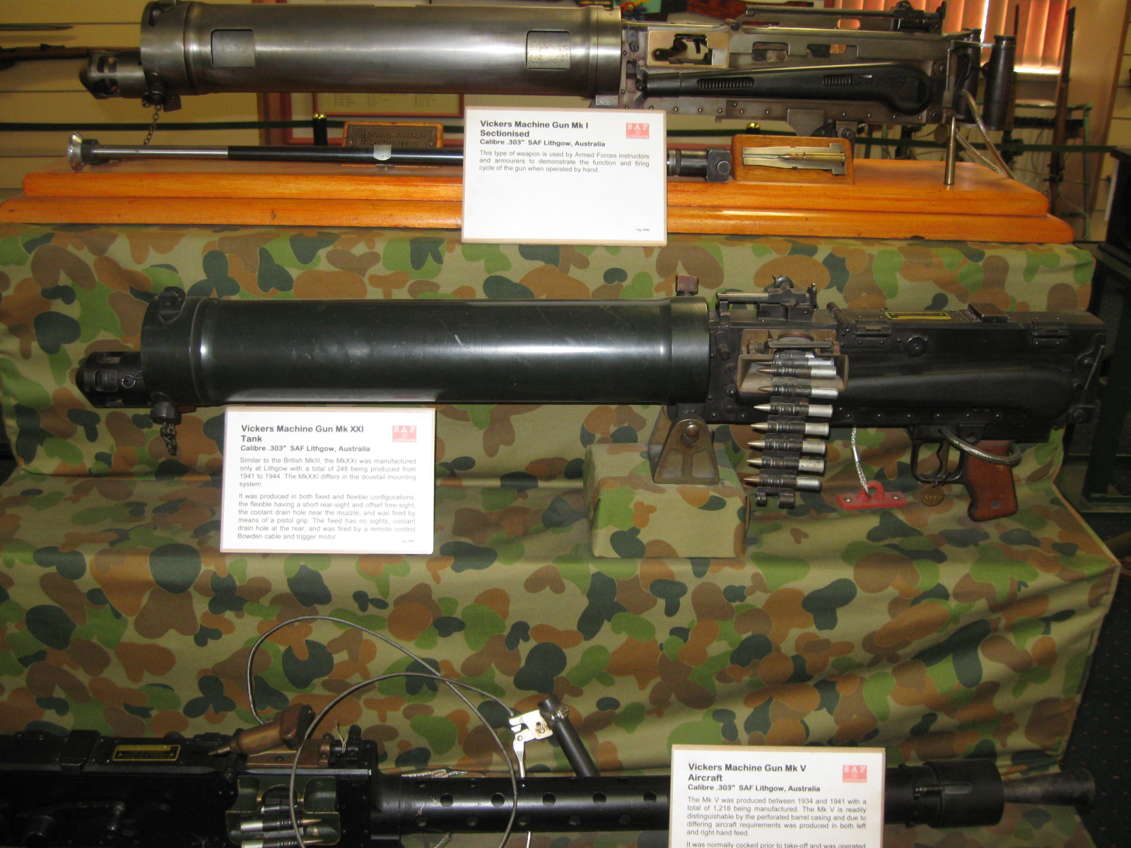

Old 21-07-18, 11:51
The Mk XXI .303 Tank Vickers. The forward end, including the barrel and cooling jacket, and the main body of the gun appear the same components as the standard .303 Vickers. The significant difference is the change from the double spade grips on the rear of the body to a single pistol grip underneath the body.
