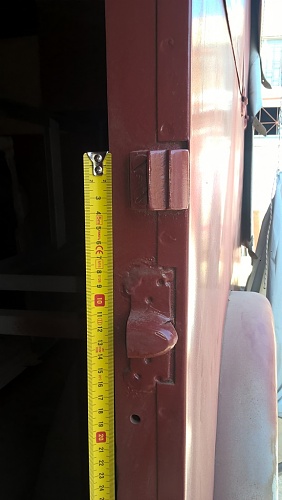

Does anyone have HUP/HUW pics or a HUP handy to checkout a body skin detail for me? I apparently didn't take sufficient notes when I took the rotten skin off mine.
What I need is detail for the cut outs in the ¾” bends where the lower panel folds around the vertical body frame at the rear side of the LH body door and again at the left side of the rear body door (they should be the same). The cut outs are to allow for the door latch and door aligning tongue. Both those bits are on my body frame so location is not a problem. I only need to know how big the cut outs are. The areas of interest are shown in red on the attached pics.

Sorry no dimensions but this is from an original example and will give you some idea.

Perfect!! I can sort it out from there. I couldn't tell from my rust marks how much clearance there was between the notches in the body panel and the door hardware.
Thank you!!

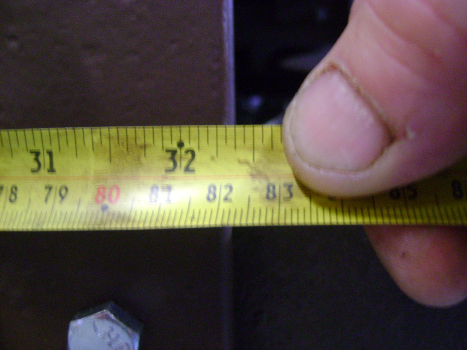

Bruce,
I hope that these are ok.

Just one confirmation: is the entire height of the bracket 23-1/4" from the bottom of the bumper to the very top? If so it seems to match the 15cwt one (pic attached), the only difference being the bolt spacing on the bottom is different to allow for the thinner 5" HUP bumper.
Also, thanks to your door latch pic I was able to finish my HUW lower skin panels. Truly a job of measure twice, three or even four times to make sure you cut only once. If anybody needs to know, the steel size is 18 ga. 76-1/4" by 30-1/2" (overall) with a corner radius of 5" and 3/4" I.D. bends front and rear.

That's correct Bruce, that's the total height.

...take this photo of the LH side of my HUW by completing the help sent to you by Jonathan..
