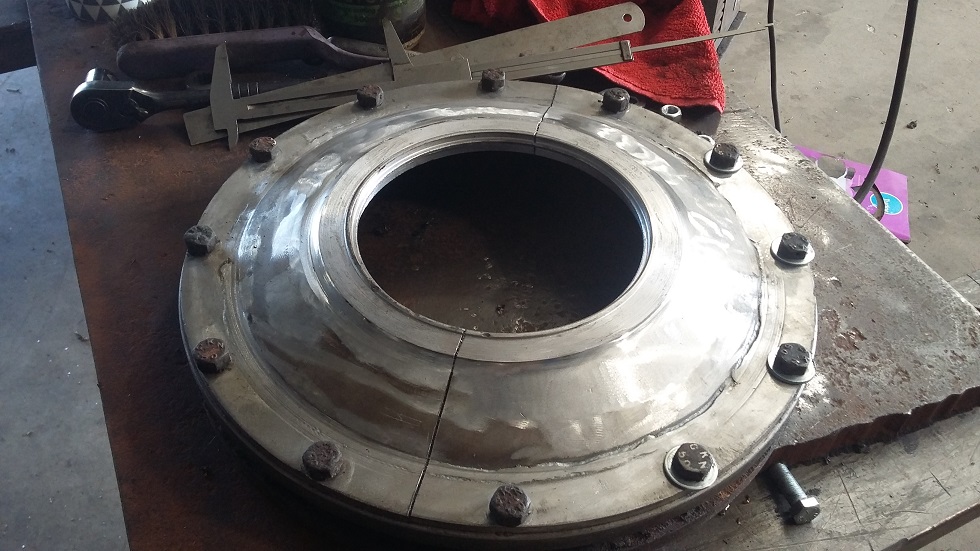

The last part is a split section. I made it in one piece, cut it in halves, then mounted it to an original drive part and then re machined it in the lathe to re centre it.
20180727_132348.jpg   20180727_142720.jpg   20180727_155615.jpg   20180727_160049.jpg   20180727_160205.jpg

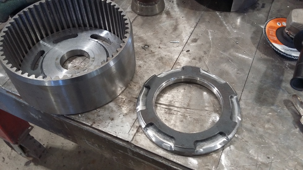

I had to complete the rest of the turning clutch drum. The chap that cut it for me left excess so I can do my welding and then machine it down to size.
20180823_140848.jpg   20180823_140917.jpg   20180824_094126.jpg   20180824_110840.jpg   20180825_095928.jpg
  #913
Old 25-08-18, 11:13
colin jones's Avatar
Posts: 1,810
He did a great job as the clutches fit in really nice. I have changed the design a bit to suit myself but it will still be OK.
20180825_112245.jpg   20180825_114819.jpg   20180825_143337.jpg   20180825_151420.jpg

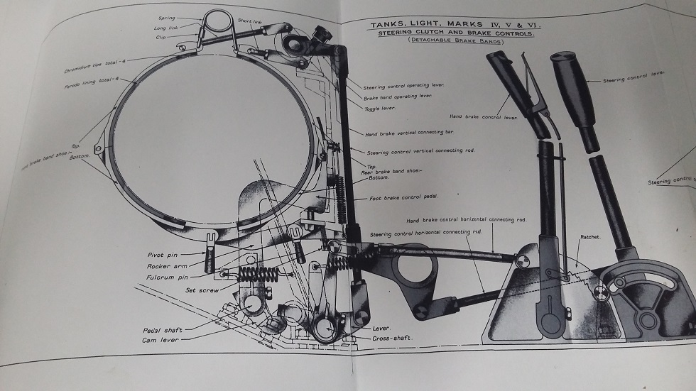

I have assembled the steering clutches but not the fine adjustment yet. I guess that will be done after installation as I don't have details of that part so a bit of trial and error to come. I have just temporarily put the newly made clutch cover on for a bit of a test fit and it is excellent.
20180828_141230.jpg   20180828_141554.jpg   20180828_141607.jpg   20180828_141620.jpg

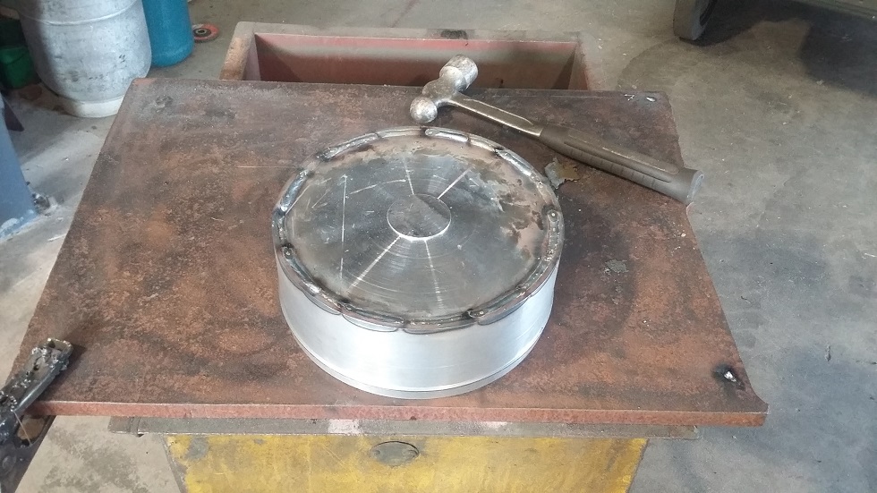

I'm still working on the engine and transmission but took a break from that and made the heat shields, mufflers and brackets. They are quite a big muffler for a small tank.
20180915_082023.jpg   20180915_082716.jpg   20180915_091205.jpg   20180915_091447.jpg   20180915_124322.jpg
  #923
Old 16-09-18, 10:39
Posts: 1,810

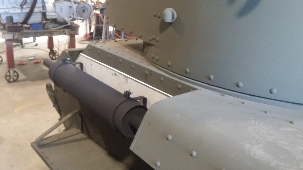

I made a really crude press die and formed the ends as per the drawing I have and some baffles for the inside. Rolled the tube to suit the ends and welded it all together. Also the clamping brackets as well.
20180915_125311.jpg   20180915_135953.jpg   20180916_131153.jpg   20180916_150759.jpg
  #924
Old 16-09-18, 10:41
Posts: 1,810
All bolted on and it's a good fit. Hopefully the engine will be fitted in the next couple of weeks.
