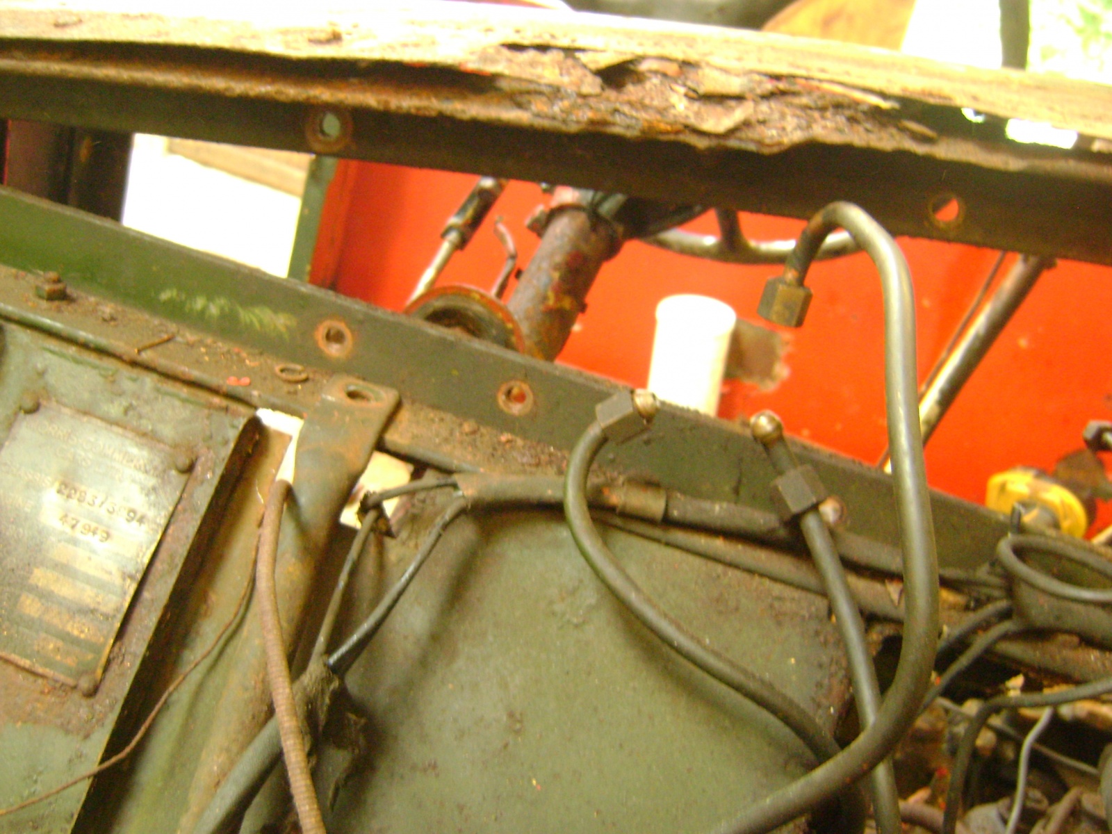

I have had a bout of the dreaded man flu and as I am unable to sit still for too long, I decided to rise from my death bed and start the canvas covers for the seat bases. I have an old back rest cover for the drivers seat, which I can use as a pattern to make a new one but does anyone have a picture of the passengers seat back rest. It's attached to the rear bulkhead by four turn buckles but that's all I know.
I don't want to assemble too many parts to the front of the vehicle before I fit the engine and as we are now in week five of a four week production schedule for the engine and that's before I get it back for rebuilding, I decided to start the rear body. There's not much of the original body left and what is left is very rusty, so its start again. There are some sections that I can use, the front bulkhead but the lower section was rusted out and needed replacement. The strengtheners for the wheel arches that are in excellent condition. Front body corner sections that need repair And the wheel arches that are in fairly good condition.
The new base, is based on a picture that I took at the Coberton collection, I assume that it is original, I think that I may have gone over the top a little but surprisingly, in its current state, its no heavier than the old body, but then as my wife pointed out rust doesn't weigh that much.

Jonathon you have the two fuel lines coming in at quite a height where mine are down level with the cab floor/pedals, where did you get that idea?
Paul

Hello Paul,
That's how they were when I got the vehicle. The attached pictures were taken as I disassembled the vehicle so I could replicate where everything was originally routed and I am using the same pipes, in their original bent form.
Hopes that explains it.
Jon

This is a pre-disassembly picture, the curly pipe goes to the fuel pipe, I suspect that it should have tighter curls.
Jon

Hi Jonathon and I see what you mean, I had all sorts of dramas with not enough fuel going in then too much till I sorted it all out, See how you go but the carbi is sensitive to the fuel pressure going in, have a great Christmas and New year.
Paul
