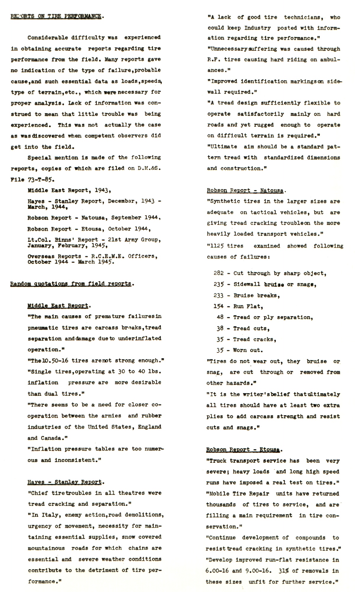

AEDB Volume 4
ID:	126054 Click image for larger version
ID:	126055 Click image for larger version
ID:	126056 Click image for larger version

Thanks for posting that Mariano.
It is interesting the amount that the different makes have different dimensions for the same size tyre.
