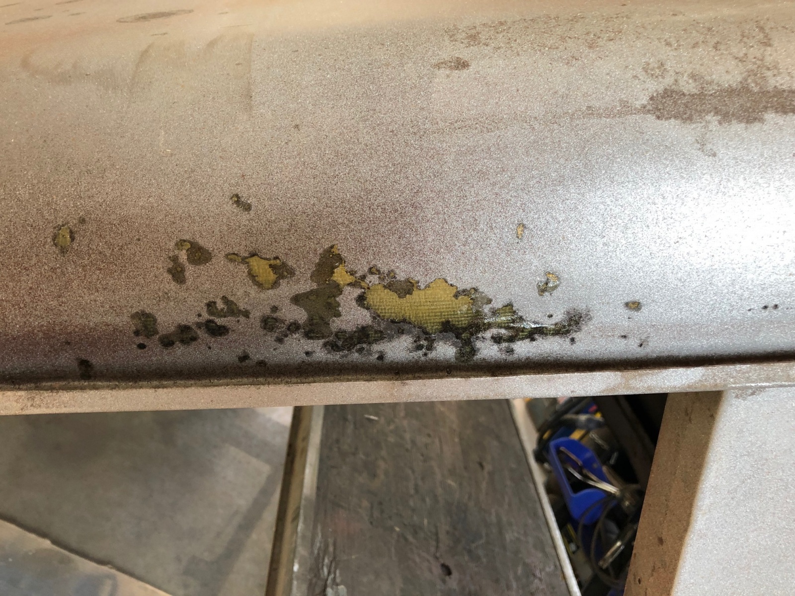

Old 16-10-19, 02:04
Wayne Hingley's Avatar
Posts: 743
I don't know what was used as a seam sealer on these trucks originally, but there was nothing left on the outside of the cab. On some of the seams inside the cab there was a hard material that I can break off in pieces. Looks like it was originally installed by hand (like putty).
I used seam sealer on every seam on my M38A1, and will do the same on this truck to keep the water from getting between the layers of metal.
d.jpg   e.jpg   F985AC47-D4A6-4BE7-A2D1-95CBF5248D12.jpeg   84304818-3429-40B0-9812-EBBD4AF94EC6.jpeg

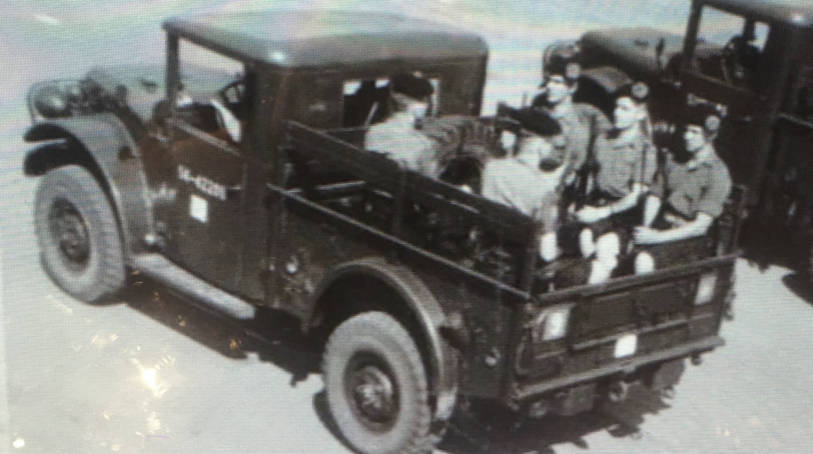

Old 30-10-19, 02:02
Eric B Eric B is offline
Posts: 580
Default Black Watch M37
Hello Wayne
Looking very nice.
Here are some Black Watch marked M37 photos as requested.
They are taken in CFB Gagetown and can be found on the National Archives of Canada web page.
e010786687-v8.jpg   e010786688-v8.jpg   e010786689-v8.jpg   e010786705-v8.jpg   e010786706-v8.jpg
Serial, WD Numbers etc.

Old 30-10-19, 03:28
Posts: 743
Default Great photos
Thank you Eric for taking the time to locate these photos. Your efforts are greatly appreciated.
The photos are very interesting.
If anyone out there can help, I have a few questions as listed on the photo attached.
The second photo is on parade, and the formation sign appears to be red background with yellow maple leaf.
The last two photos are one of the M37's that my father purchased from Gagetown in 1967. Similar marking patterns to the photos posted by Eric.
black watch m37.jpg   black watch m37 a.jpg   black watch m37 b.jpg   black watch m37 c.jpg
