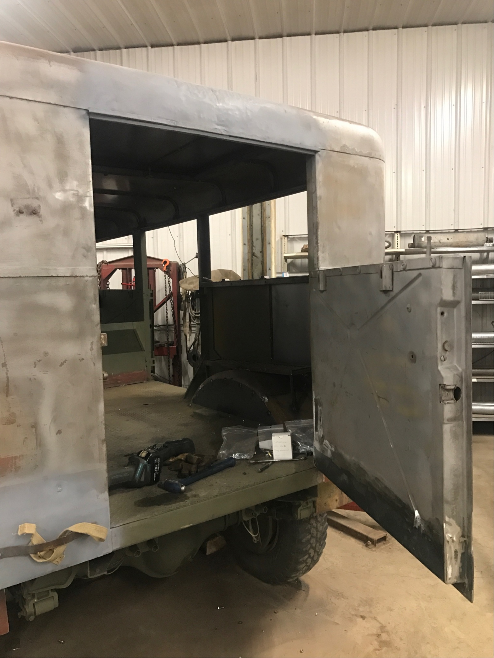

Some of the winter progresses on the HUP .
Burning through the grinder discs and mig wire.
Any chance someone has a spare RH door ?
