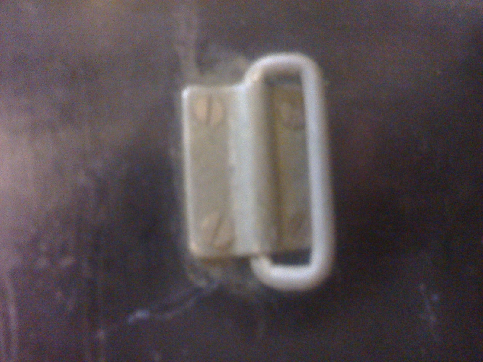

Chris has very kindly donated two HT battery boxes. They've obviously been used as oddment drawers and the lids are missing, but I'm looking forward to doing something with them.
The boxes are Bakelite and I'll be looking for suitable Bakelite/plastic/Tufnol sheet to make the lids.
I'll also need the four metal loops for the canvas straps that are bolted on each side with four small nuts and bolts......If anybody has any I'd be happy to hear from you.
So sad that I can't share any of this with Dave anymore!! Ron

Whilst the lids are away and my mate John is making a press tool to make the plates for the canvas carrying strap 'D' rings. I've made some 'D' rings from a heavy gauge wire coat hanger that's been knocking around the workshop for years, and the spreader plates for inside the boxes.
I've also been making the holding frames for the batteries......Based on the few available pictures that I have. I couldn't quite finish the job today as I've run out of 5/16" round bar for the uprights. Ron

They have the external part of the sockets intact which is a nice bonus.Although I've no idea what the four holes are around the sockets are for? Both boxes are the same. They also have the two holes at the back which can be filled with a 2BA countersunk screw.
If anyone has anything like, similar looking plugs as in the second picture going spare? Please let me know. Ron

My friend John made a press tool come drill jig and formed some 'D' ring clamps from the correct gauge brass (one extra for Mike)
Here is the finished result with engraved lids and painted holding frames.
Ready to install behind my WS11 where they will barely be seen Ron
