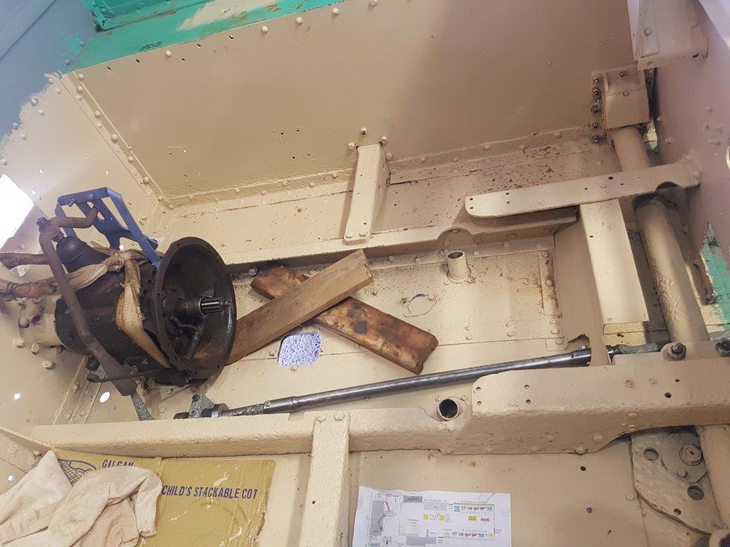

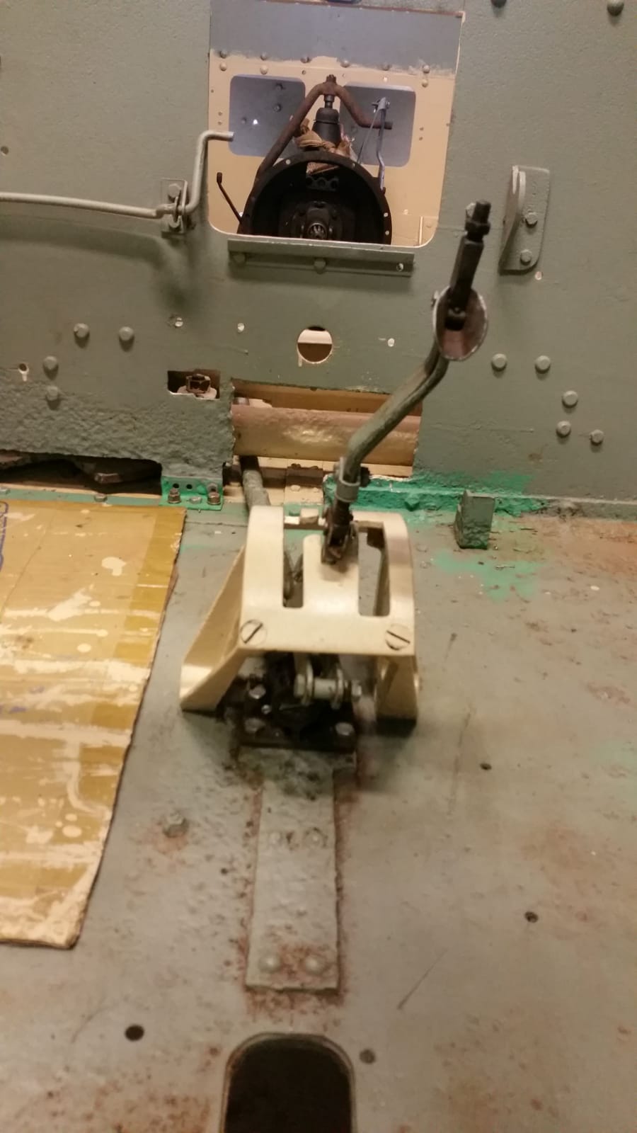

Today we did some work on Transmission gear, just to check that the Transmmision Gear is functioning and we can shift gears, (we opend and work on the transmission gear checked and Clean sludge)
add some photos tooked today.

Hi Israel, here is the pic which could help you as well.
UCw Mk.III
