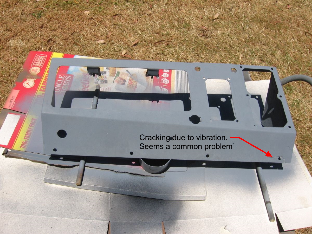

Yes, I had considered that but there would be very little steel for the filler to adhere to. It would only be the thin edge of the steel at the hole.
I have noticed the instrument panel is subject to a fair bit of vibration which could result in the filler falling out if not backed up. My reason in the first place for putting the brass shim behind the hole.
As shown in the photo I've had three instrument panels that all have cracked at the same location from what I can only assume was vibration with resulting fatigue failure.
All is not lost. I will put that fascia up on my shed wall to remind me to check the fit of things before modifications. As someone once said "You learn more from your failures than you do from your successes."
