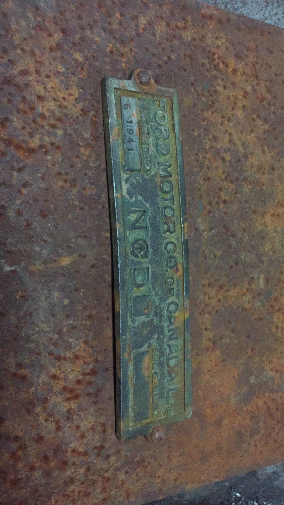

Old 16-03-19, 02:04
Kirk Armitage's Avatar
Kirk Armitage Kirk Armitage is offline
Join Date: Sep 2003
Location: Ottawa valley
Posts: 106
Default Data Plate
Nice to see another early example, 6 1941 does the serial number start with T L ? F
Regards K Armitage
Old 16-03-19, 04:24
Join Date: Jun 2011
Posts: 1,171
Originally Posted by Kirk Armitage View Post
Nice to see another early example, 6 1941 does the serial number start with T L ? F . . . . (edited)
Certainly an example of an early data plate attached to its original fender. Now to verify the fender and data plate belong to the hull, using the identifiers particular to those carriers. There are a few visual indicators that point to an early production carrier, such as the correct track adjuster wheel arms, mounting bracket for the early track adjuster ‘crook’, and the lack of a modification to install the sighting vane.
The data plate does not appear to hold the TL XXXX F one may anticipate seeing. Perhaps the 1790 serial number, in addition to the month/year window.
I agree with you, Kirk: it is nice to see these early examples. I am jealous, and Samuel already knows that from our discussions on his FB UC group.

Old 16-03-19, 23:48
Sam Tremblay Sam Tremblay is offline
Join Date: Jan 2019
Location: Stanstead, QC, Canada
Posts: 14
the serial number 1s only 1790
Old 17-03-19, 00:31
Join Date: Jun 2011
Posts: 1,171
That is swell!
